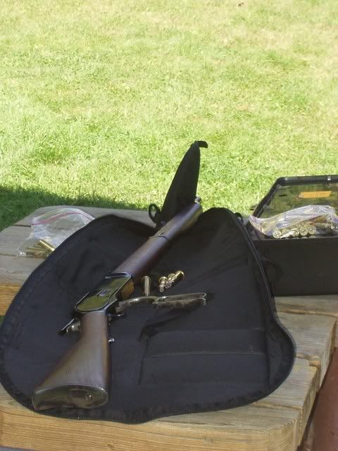

The rifle ready to go...

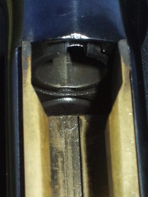

(Hobie) the last two pics I did for you, Thats the belly of my NWMP CArbine your looking at.

The type of bullet (jacketed vs. cast) and this mild load are not the cause of the splits. That simply is not logical. The splits are the result of pressure (and not excessive pressure) in a too brittle case which is trying to expand in the chamber.
I haven't had a single reformed .348 Winchester case split.
I think the .50 Alaskan case is best choice for conversion just because of ease in forming. I'm going to try a batch annealed before forming and then a batch annealed after forming. I have the cases, might as well see which is best.
I see we are getting similar trajectories and POI using the issue sights. If the manufacturer duplicated the dimensions correctly then one has to wonder if Winchester deliberately did this to "increase" the usable range for most users (military users anyway) because those trajectories work for shooting at standing soldiers (or on horse) coming right at you. Just hold center-of-mass and you'll get hits on out there! That is not how we do it, of course, so we need to make modifications. For me, 3" high at 100 would probably work and the limited range my range estimation and the trajectory would give me is of no consequence. I'm hoping that moving to a tang peep will allow me to correct that.
Now, have you weighed these things? Can you imagine carting enough ammo around on your horse (or mule) to engage Apaches a way out there in the boonies? I can easily see how an individual Mountie or Scout using one of these rifles could have run into ammo re-supply problems.
Hobie, if I may ... from the looks of the splits, the fps and using copper clad bullets - my suggestion would be to load up some annealed brass with 55-60gr of either Fg or FFg powder and a 300gr cast bullet. The pressure curve will not be a long duration curve and the psi will be less than the smokeless.
Appears to be a high pressure being created in the case using the CC bullets and I presume the cases are crimp.
Using 348's - annealed - Not Fireformed and black powder: nicely shaped brass to the chamber and no splits.
