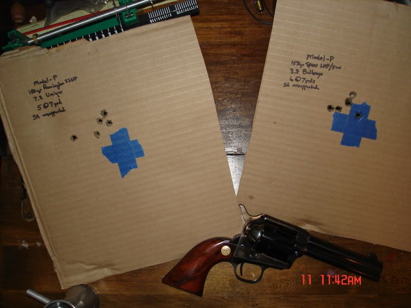

Cimarron Model P range day
Went out and did some laod testing with the new .357 Model P this morning.
Tried 4 different loads as well as some factory store bought.
The factory fodder was Winchester 125gr .38spl +p SJHP. They shot well enough around 2" 6 shots @ 7yrds, standing unsupported.
Handload 1
158gr LaserCast SWC
6.8gr Unique
6 @ 7yrds
3+" group
Handload 2
158gr Speer LHP/SWC
3.5gr Bullseye
6 @ 7 yrds
3" group ( I jerked the last shot - First 5 were @ 1-1/2")
Handload 3
158gr Speer LHP/SWC
3.8gr Bullseye
6 @ 7 yrds
1-1/2" group
Handload 5
158gr Remington SJHP
7.3gr Unique
5 @ 7yrds
2" group
And of course, pic of the good targets. :mrgreen:
Re: Cimarron Model P load testing
Not bad. Not bad at all.
