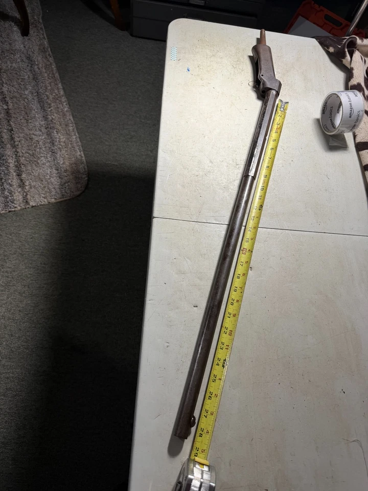

Did a few things on this Union Hill today. Started by replacing a few worn screws in the lever and link, and a couple buttplate screws since those with the gun were too long, and too large diameter. Then figured I'd take a shot at taking the old barrel off, and knew after 140 years or so they often don't cooperate! But this one fought me more than any I've ever removed, and it's still not off the action!
I started by clamping it in my barrel vise with oak blocks and put the action wrench on to break it loose, but no go. So I added a little heat and a little Kroil to the junction between barrel and action, but still no go. I cranked the vise down extra hard, and added more Kroil, and more heat and it felt like it broke free. But it was just y oak block breaking and a piece came out the side of my vise!
I switched to a pair of ironwood blocks I built years ago for stubborn barrels and after yet more heat and more pulling, it still wont budge!
At this point I left it in the vise, and hung some weight on the action wrench to see if constant weight hanging on it overnight coaxes it at all. If this doesn't come loose soon I'll have to take it to a friend's place and see if I can stick it in his lathe and use a parting tool to remove metal off the barrel where it butts up to the receiver and maybe that will free it up? I'm out of ideas to break it loose now.

I am not patient, so I put the barreled action in my padded bench vise and used a hacksaw to make a 1/8" deep relief cut in the barrel as close to the action as possible. Less than 1/16" left right next to the action.
When I finished a few minutes ago I put it back in my barrel vise with my ironwood blocks, and put the action wrench on it. I got ready to give it what for, and it turned like it was almost hand tight! The darned cut worked great and the action came off the barrel with ease!
Now for the other good news! I hand tightened the Schoyen barrel into the action and it stopped just about 1/8th turn shy of indexing up perfectly! I'll try to tighten it a little more, and if it goes in place I'll check the breech block for proper headspace and .003" crush to know if it's also good!
I couldn't wait, so I cranked the Schoyen barrel down tight, and it wont quite index without tightening it too much. I'll stone the face of the receiver and it should go easily then.
Ballard breech blocks are easy to adjust if close by stoning the back of the block where it rides against the receiver opening. I'll also do a small amount on the front to clean up some pitting around the firing pin opening. These should all make it tight, and headspace correctly plus index correctly.
Right now the lever closes, but takes a fair amount to close it, and open it. More than the proper crush they need.

Considering the amount of heat I put on it three times with my Mapp gas torch I doubt the hacksawing added any heat. It wasn't even lukewarm once I finished. I think it was simply the shoulder of the barrel cranked too hard against the receiver, and once the cut relieved that pressure it came off easily.
I put the new barrel in my vise, and cranked it down pretty firmly, but it wont index up with the amount of pressure I like. So I'll take it back off and stone the face of the receiver a tiny bit and try it until it comes up with the right pressure. Then I'll stone the rear of the breech block also until it locks up correctly. After that it's all coming apart and I'll polish the action, breech blocks, lever and buttplate. Then send it all to Al Springer. While he does the CCH I'll refinish the stocks and get the checkering touched up also. I'll wait until after the end of the year to avoid the busy shipping times now.

Got the Ballard all fitted now. The extractor was for a .38-55, but I happened to have one for a .40-63 that fit the extractor cut. The breech block locked up perfect until I installed the extractor and it was rubbing somewhere on the barrel and made a mark on the face of the breech block on the left side. I marked it up with black felt pen and began removing metal with my grinder. Must have had it together and apart 15-20 times before it finally closed normally. I was afraid to remove too much metal where I saw rub marks.
Took the breech blocks all apart and began polishing the parts. The left side of the action is going to take a lot of block sanding to get it smooth! The rest is easy as it's smooth, but just dark.
Also wrapped the barrel with 60 grit and began sanding the forearm over it to open up the channel to #4 weight round barrel. I removed the vertical sides as they got pretty thin and fragile. This forearm will sit under the barrel, not up the sides. In working on it I also discovered the forearm was checkered! There's so little left I never noticed it, but might show better once I strip the finish. Then the checkerer can have a pattern to know how to lay it out. Lots of tiresome work before I can send parts to Al!

Got the Schoyen .40-50SS barrel fitted and the breech block also fitted.
Change of plans on the buttstock. The stock isn't really going to be as nice as this Ballard deserves. It needed something higher grade, and after digging through my box full of old donor stocks I found a stock and forearm that fits the bill!
This will no longer be a Swiss buttplate, and instead a hard rubber repro checkered black buttplate. The higher cheekpiece will make it work better with a scope mounted, or with taller tang sight. The forearm is much too bulbous, but plenty of wood to work with to shape it down to typical Ballard size. Then just need the forearm checkered as the buttstock is great.
