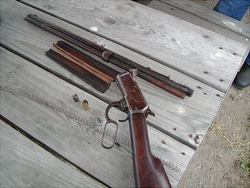

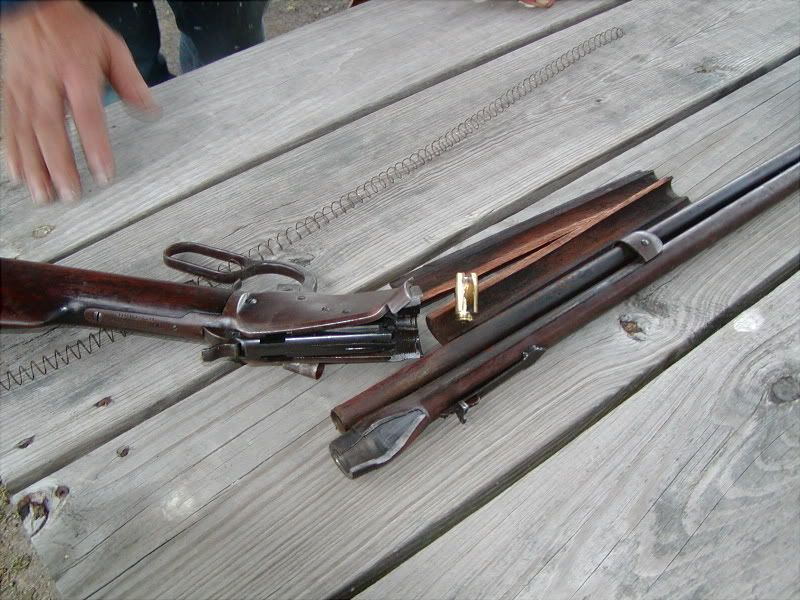

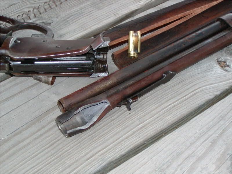

Here's the pics of the damaged rifle and brass:
So, whadya'll think?

General consnesus on the bullet was that it was a double bullet loaded case. MAY have been double charged, too - but that's only a guess.

It doesn't display much of the barrel obstruction indicators (bullet several inches in barrel is where barrel would have split). I am not the guy who owns the gun or loaded the ammo but it looks like a full case of Bullseye to me.

the way that cartridge case is torn at the base rather than at the mouth is convincing for the two bullet theory.
If you look at the .45 dummy with two bullets, there wouldn't be anywhere else for the pressure to go but sideways.

Can't say I’ve seen that kind or damage on a 92 before. Have seen several 1876s and 1886s that have blown both the barrel and the frame. All were due to over charge (double and triple) of smokeless. My guess is that this was an overcharge of a really hot powder like Bullseye.
I doubt it was metal fatigue, that’s quite a bit of metal that was moved, not sure a standard 38 WCF ctg could do that.
Double bullets? Don’t know, I would have expected the barrel to bulge, blow off the head of the case, but not completely blow apart both the barrel & frame.

Several possibilities. Most likely a double charge of fast burning pistol powder + a non nickel steel barrel.
Non nickel steel barrel - max pressure rating 28,000 psi
Double charge of a fast burning pistol powder = 50,000+ psi
= barrel failure :cry:

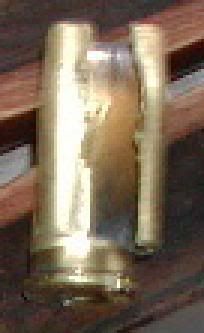

Kinda did some blowups of the split case in question here :
I know its' not the best quality here abouts - but I noticed that the walls aren't "bulged" like you would see with a double bullet in a .45 case. I also noticed that the burn marks are also at the edge of the opening, as well - instead of just at the base near the primer hole.
My question is, would these observations be consistent with a "double-bullet" or just an over-charge of powder? If it was a double bullet and the first bullet just slipped by the crimp ahead of the second bullet - wouldn't it just be loose in the case and might've keyholed in the chamber when fired and caused the excessive build of pressure resulting in the damage?

Presidio, if you look at the brass at a little less magnification, you can see the gray area near the case mouth appears to be lead smear, it's just shiney gray, almost like somebody dipped it in molton lead, whereas the scorch down in the bottom is definitely a burn mark.
I'm still convinced it was a double balled case (as was Steve Young)
A double balled BOTTLENECK, low pressure case like .38-40 would be a serious bomb when the candle was lit. The charge, probably compressed, would instantaneously ramp pressures waaay out of sight. The bottom bullet would obdurate to fit the chamber BEHIND THE BOTTLENECK, effectively creating a solid obstruction larger than the chamber throat (like a cork stoppering a bottle from the inside) for a few microseconds, as the powder's progressive burn went totally postal because the bullet didnt' move the heck out of the way, until at some point, as the chamber bulged, that obdurated fat bullet, and the one in front of it, finally squirt forth, perhaps mostly as lead or vaper, when the chamber vented to the side. In other words, because the chamber is tapered, the resultant "plug" may have been so tight that the bullets simply vaporized as all he77 broke loose.

As bad as it looks, it's kind of nice to see the bolt still where it's supposed to be.

Pop, I read about that secondary detonation and it supposedly happens with slow powders, because they are harder to light. Fast powders ignite immediately so there would be no delay to let a bullet get stuck before going off, and no unburnt pockets. That's why they say not to load down slow powders.
That "cork" description really helps me understand what happened, it didn't occur to me that the lower bullet would obturate and block the chamber. I thought the pressure happened just from the extra weight, but, man, I can see the problem there.

w30wcf
Posts: 1358
Location: Erie, PA
Re: Blown 1892 Winchester .38WCF
Post by w30wcf »
Guys,
Based on the collective experience here, it most likely was either a double charge of a fast burning powder or 2 bullets insde the case.
Regarding the possibility that an increased powder charge did the mischief, unfortunately "Sixguns" .45-90 (non nickel steel barrel)blew up in a similar manner with a single slug and 5744 powder :shock: In addition, P.O. Ackley shows a picture in his book(s) of a blown '94 .30-30 that reportedly had a double charge of Unique.
w30wcf
aka John Kort
aka w44wcf (black powder)
NRA Life member
Posts: 21211
Ranger Clay, welcome to the forum.
DJ, NJKJ, Lefty, & AJ; thanks to you all for your discussion and expertise. I feel we do a dissevice to ourselves and other reloaders when "ostrich" over issues such as this.
Reloadin' is a serious undertaking and ones attention should remain on the task @ hand.
Mike Hunter
Posts: 285
Joined: Thu Dec 20, 2007 6:28 pm
Post by Mike Hunter »
Range Clay
Thanks for joining the forum. As you can see there is a lot of interest here as to this 92.
Do you know if the owner is planning on having a "forensic" investigation done on the 92?
Would really like to hear the outcome. Also did you take note of the SN of the rifle?
Mike Hunter
www.hunterrestorations.com
Mike Hunter
Posts: 285
Ranger Clay
Sent you a PM
Mike Hunter
Won't comment on the "whys" - 'cause I'm not that edjumakated on them things.
But the rust on that carcass is a dang shame.
I'm not too supprised somthing bad happent to it as a result of neglectful reloading (weigh your cartridges!) ... as there seems to be a good bit of neglect in other areas...
RangerClay
Posts: 9
Joined: Wed Jul 16, 2008 3:58 pm
Location: Northern NY
Post by RangerClay »
Mike Hunter wrote:Ranger Clay
Sent you a PM
Mike Hunter
PM returned.
Thanks for the welcome everyone. I only wish it wasn't this accident that brought me here. I've been a lever gun maniac since I was kid and I really like this place.
One thing I would like add to this story that I have recently learned is that the shooter was using leftover hunting loads (very much against SASS rules). So I (in my novice opinion) am going to assume that this 38-40 probably had a double or triple charge of some very hot powder. No one will ever know and I hope I never have this happens on my watch again.
I'm going with a double charge of Unique.
I shoot nothing but old Winchesters, including a 1892 in 38 WCF. I prefer to use a slow enough powder such that a double charge simply cannot fit in the case. 2400 is the fastest powder I use in the old Winnies, except for Unique in my Winchester Model 53 25-20.
Kansas Ed
Posts: 1261
Location: Wichita
Post by Kansas Ed »
To add one more thing to the mix: I load for 3 different 38-40's and have loaded this little engine that could for years. Recently I tried to reform some Remington 44-40 brass for my 38's. No matter what I did, my dies refused to put a decent crimp on them. The brass was just too thin for the Lee dies. Yes, I also tried the FCD die on them, but under magazine pressure they still pushed the bullets into the case. If they were reforming brass, this might have been one piece of the puzzle.
Ed
Paladin
Posts: 2071
Location: Not Working (much)
Post by Paladin »
Pop Watts wrote:Just one more thought to put into the mix - who knows anything about "secondary explosive effect"?
In theory it can be caused in cartridges loaded with light charges of smokeless powder. The primer flash does not ignite the powder column instantly because it is lying on the bottom of the case. The primer flash however has enough force to move the projectile foward into the lands of the barrel and then it jams there. Now the powder column burns in an increased space caused by the foward movement of the projectile - which is now stationary and jammed into the lands of the barrel. The result is an explosion rather than ignition of the powder and pressures can reach extreme peaks. All of this happens in an instant of time.
I would like to put this theory up for discussion.
There is reason to be cautious about using too light a smokeless powder load in these old black powder cartridges and many reloaders will use wadding to keep the small powder column pushed against the primer flash hole to get consistent ignition.
I have over 20 old 1892's and shoot them regually - but those photo's scared me.
Just my thoughts.
Pop
A small charge of smokeless powder resulting in explosive detonation is a reoccurring problem. I teach advanced explosives to some military members and curtain types of smokeless powders can be used as high explosive under the correct circumstances. One of the reasons I don’t load light charges in my toys.
Old Time Hunter
Posts: 2388
Location: Wisconsin
Post by Old Time Hunter »
Guys, very interesting to say the least and of course it is great that there wasn't any physical harm.
Currently I'm in Pop's, Sobenk's and Paladin's camp with at least one foot, but touch'n a toe in Kirk's position also. Then again, we had a kid in camp a couple of years ago that brought is great grandads '92 chambered for 38WCF with a pile of hand loads his pa gave him. As we were knock'n over frying pans at about 40 yards, out of the corner of my eye I noticed the kid chambered a round with a little hitch in is lever swing. I yelled STOP!!!, fortunately he did not pull the trigger. It took just slightly more pressure than normal to cycle the lever to eject, but upon investigation...his pa had loaded a .427 pill in a .38-40 case and when chambering the lever had enough force to push the bullet back into the case and chamber reform the case to where it chambered. Shutter to think what would have happened if he'd pull the trigger. I can see the bullet jamming in the neck of the cartridge and the pressure having no where to go but out. Out of 200 rounds the kid brought, we found seven with the wrong bullets. Found out later his pa was load'n his 44WCF's the day before he loaded his kids 38WCF's and must have accidently left some of the .427's in the hopper!
Ummmm, maybe he had it in for the kid?????
TNBigBore
Posts: 637
Joined: Mon Sep 10, 2007 1:36 pm
Post by TNBigBore »
Seeing those photos has me a little concerned. I have a first year 1892 38WCF and have been shooting 180 grain jacketed bullets over 10 grains of Unique for my hunting load. It makes a noticeably bigger boom, but I thought this was a safe load even with the older steel of my barrel. Am I off base here?
TNBigBore wrote:Seeing those photos has me a little concerned. I have a first year 1892 38WCF and have been shooting 180 grain jacketed bullets over 10 grains of Unique for my hunting load. It makes a noticeably bigger boom, but I thought this was a safe load even with the older steel of my barrel. Am I off base here?
In this case, I doubt it was Unique by itself ..... I'm going with a double charge of Unique. That being said, I know that a lot of shooters use Unique, and it is probably perfectly safe, although much easier to have a double charge than a slower powder that fills the case. For cartridges that were originally black powder, I never use a powder faster than 2400. In general, the faster the powder, the sharper the pressure spike for the same velocity. Blue Dot gives approximately the same pressure curve as FFFg and 2400 gives about the same pressure curve as FFg. Powders slower than 2400 actually give lower pressure curves than black powder for the same velocity (contrary to urban myth) and powders faster than 2400 give higher pressure curves. The faster the powder, the sharper the spike. Here is an example of some pressure curves that illustrate the point ....
Paladin
Posts: 2071
Post by Paladin »
I just found this and thought I would share.
You should never drop to far below 80% load density.
A known condition named detonation (excess pressure spike) can occur with cases that are not signifacantly filled with powder. Some years ago the U.S. Ordnance and DuPont ballistics laboratories were able to duplicate the strange phenomenon called detonation and they had determined that excess air space in the cartridge case to be the trigger for detonation.
How to figure load density.
Powder charge weight divided by case capacity equals load density.
Example: Powder charge 40 grains (divided by) Case capacity 50 grains = .8 or 80% load density.
Mutt
Posts: 502
Location: South Coastal Texas
Post by Mutt »
Shore Nuff' ruined a fine rifle. Hope the person and those around them weren't hurt none. Hate to see a gun like that.Just think of all the skill , labor and the keeping up the rifle all those years. Nuff said , getting mad now. Doggone it !!!!.................................Mutt
