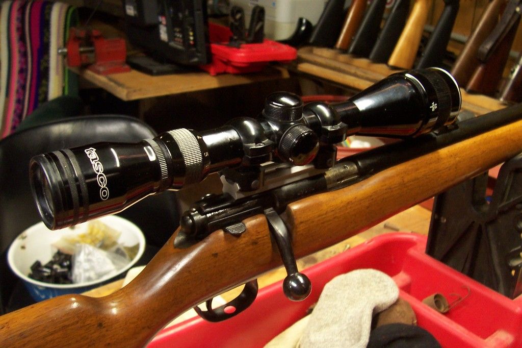

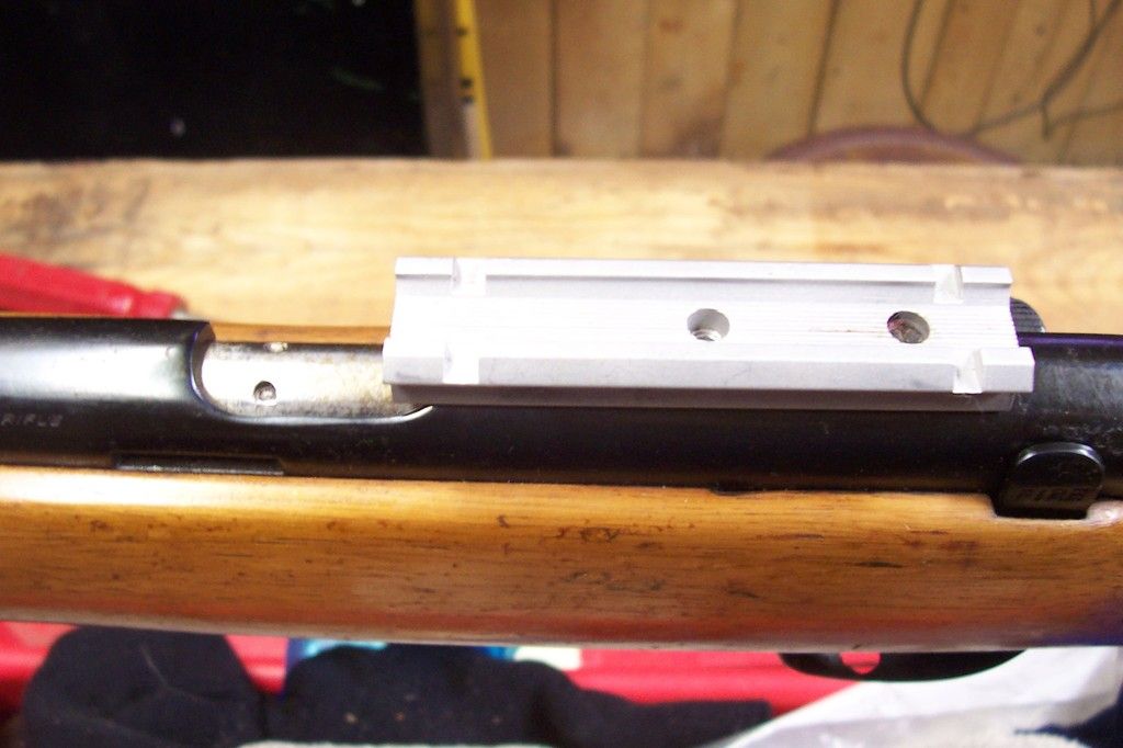

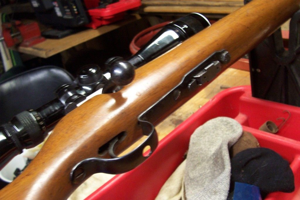

I bought this rifle about 10 years ago with no mag,thought my 19 nra with factory stock and mag with the little screw that is as rare as hens teeth would work ,but it didn't so it set on the rack since then till last night i was digging around the gun room and picked up a savage 56c that i bought somewhere some time ago i can't remember when or where but pulled the mag and stuck it in the 19 with the missing mag and presto it worked perfectly.so i ordered a 10 rd from numrich and got to looking and found this scope block that lined up perfectly with the 2 odd holes in this action.Have to drill out 1 hole and make a bolt for the 1 over size hole in the action but think it will finely be a rifle i can shoot after all this time.some one has mounted it in a different stock with a odd foreplate but it should work out good now.

got the savage 19 together and come to find out why the sites were all crooked the scope wont adjust enough to bore site it.off to 1 side when drilled i think.I am ordering some millet rings with the adjustments on each side to bring it to center i hope. it runs out of adjustment about 2" shy of center from the left side.ans the iron sites were all the way to that side also.mite be a bad barreled action or something i can work out with the other rings.I have a set on that new savage 22 mag i just built but don't want to take it back apart so i will get some new ones. drilled out the wrong hole in the mount and had to turn it around backwards but it still worked and opened up the ejector hole better too. I will get some pictures up when its done or tossed out one or the other its parts.
