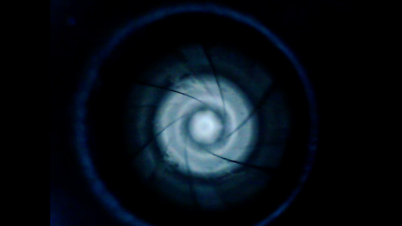

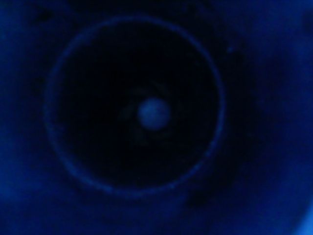

Look again! And you probably need a bore lite to get a Really Good look. Before Cleaning:
Then after scrubbing to get the residual lead out:

Re: If You THINK Your Guns Are CLEAN...
The barrel started out Sat. am like in the bottom picture... by Sun. pm it looked like the top! Throughout both had days we had several targets that ranged from 16"x24" buffalo silhouettes to 4" circles. Obviously at differing distances, from 25yards to 15 feet. Any misses were strictly due to me! Poppin' off shots when that derned front sight thingy was in hiding! Or... had green grass behind it, instead of white, black or red target steel!

Well dark or sooty doesn't mean they wont shoot well. Bad rifling, or leaded up surely means they wont shoot as well. I've had some bores on old guns that I thought needed a new liner, or new barrel when I bought them! After a thorough cleaning with a lead removal patch on a tight jag, they often look very nice!
Earlier this year I purchased a cheapo $14 bore scope off Ebay with a 15' cable. It's a 5mm, with LED lights, so it fits even my .22 bores. Simply plugs into my laptop and allows me to closely inspect every inch of my bore. I didn't expect much for $14 and free shipping, but was pleasantly surprised at how ell it works! It helps if I push a white patch in the bore with the camera lens. The white reflects the light and really enhances the picture.

I had trouble uploading this video to show the interim step, after looking down the barrel with just light from a light bulb, or a standard bore lite, (you know, those curved plastic thingies), I thought I'd plug in the bore scope and really take a look... my son said, save that as a video... so here it 'tis, warts and all!
Click on pic!
