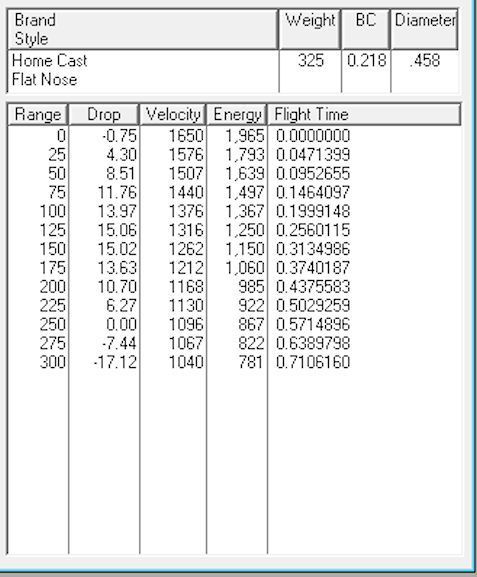

My load for my 1886 Browning Rifle is a 325 grain cast bullet over 36 grains of AA5744XMP in Remington cases with a WLR primer. I've never had it chronographed, but according to reloading manuals I can expect about 1650fps at the muzzle. This will yield an arc similar to:
As you can see, with a 250 yard "zero", I'm approximately 15" above the line of sight between 125 & 150 yards and... over 17" below the line of sight @ 300 yards! As Pisgah points out, there's "flat" and then there's flat! Range guesstimation becomes critical.
And, at 1650 fps you'll need a hard cast bullet with good lube, or you could choose a jacketed round, but you're still quite limited in speed due to pressure limits of the cartridge and rifle. Not to mention how you handle recoil! And, at range, bullet stabilization enters the picture. Depending on the twist rate in your rifle, you may be limited on what weight bullets at what speeds they will stabilize enough to have great accuracy. If your twist rate is fast, (say 1:15), it'll want heavy bullets shot slow, a slower twist will allow lighter bullets to be shot faster for best accuracy. I'll admit, you can get lucky and get a load that performs well, right from the get go... but plan on doing a lot of experimenting... darn near half the fun of having one of these old buffalo rifles!
