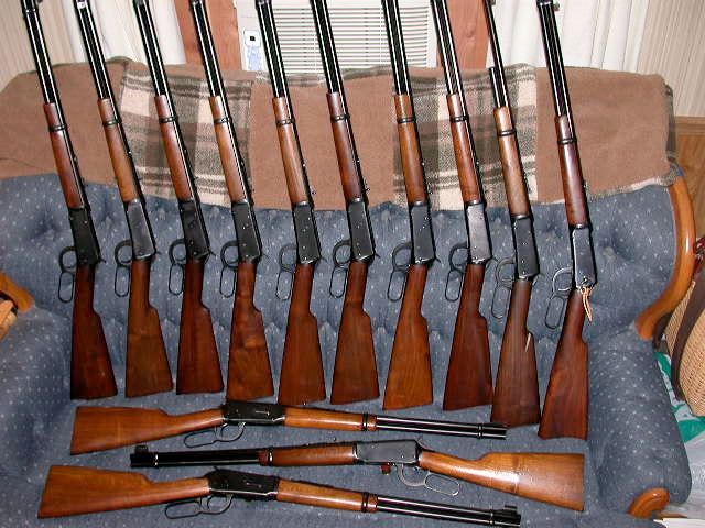

You want us to pick between sisters, one sister over the other??? NO WAY!!! :D :D :D You have to have and love BOTH calibers, my friend, so you can respond as the 30WCF / 32WS spirit moves you. Yes, it's absolutely a spiritual thing!!! :D :D :D
Here are the 30-30 / 32WS Winchester "sisters" that move my Spirit:
Model 94 carbines in 30-30 (30WCF) and 32 WS:
(The 32WS top front and prewar 30WCF in the middle standing now belong to other Levergunners here!)
The Winchester Model 64 rifle pairs in 30WCF and 32WS that move my spirit:
Picking between the 30WCF and 32WS calibers is too difficult a choice!!! :D :D :D

:shock: WOW Victor!!!!!!!!!!!!!!!!!!!!!!! What a beautiful collection.

Model 71 Alaska-------Thats some fine looking long forend carbines and 64's you have there. I see you buy with "condition". :D ------Sixgun ------------- I gotta laugh though, as collecting these Winchesters sure is a disease and you got it bad--no cure for you :D

mod71alaska, you need to pay more attention to condition!!! WOW!!!! :lol:
"That'll Be The Day"
Posts: 28965
Victor -
Those pictures just make me smile! What a stunning collection!!! 8) :D

Nice collection there Mod71!

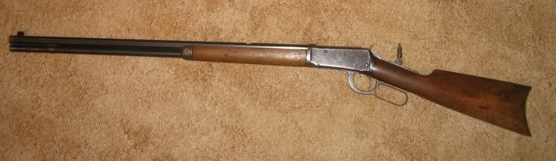

Here is a picture of a 32 WS built the second year of production (1903) still shoots great, shot a deer with it this past fall. The rifle has been in the family since new. I shoot it in a match once in awhile.

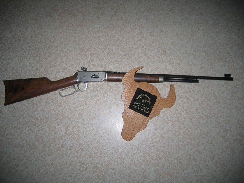

This my other 32 WS that gets shot in a lot of matchs, it even lets me win, place or show once in awhile if I do my part.
Nothing against the 30 WCF, I like them too. The RCBS mould 170 with a gas check is general the bullet that I use in the 32.
