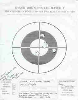

I sight my lever actions in at 100 yards and use a 3" target dot to sight on. I use a six-o'clock hold and I DO rest the rifle forend in my off-hand. I adjust my sights so that the bullets strike well up in the target dot thus ensuring point of aim out to 150 yards with a tad of hold over at 200 yards.
Here is a target I shot some time ago. I saved it because I have a buddy who like you thinks a lever action rifle just can't shoot anywhere close to a bolt action rifle. He doesn't believe that anymore. With this Winchester 94, I can shoot groups like this all day long. This is no BS or blow.
Here is a target I shot with a Model 94AE with the terrible rebounding hammer, terrible trigger, and terrible tang safety. Again a 3" target dot with the rifle forend held in my off hand and a six-o'clock hold. This is no BS or blow either.
I mostly shoot my lever actions with three rounds in the rifle -- two in the magazine and one in the chamber. Doesn't affect the results one way or the other.
Both of these rifles will shoot better than quite a few bolt action rifles I have owned or seen others shoot.
I got my first lever action rifle (Winchester Model 94 .30-30) in 1956 for my 13th birthday and I have used it regularly since then along with many others along the way. There will always be nay-sayers about lever action rifles but if they were so lousy, they'd have faded long ago.
EDIT:
NOTE -- Those targets were shot with Factory ammo -- not custom handloaded ammo. Says a lot for Winchester factory ammo. At least their Super X .30-30 170gr PP ammo.
