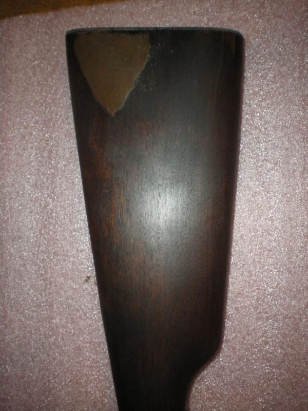

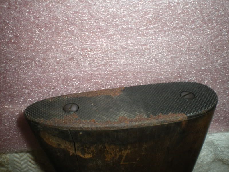

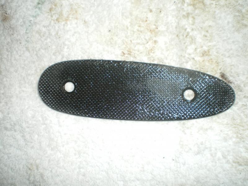

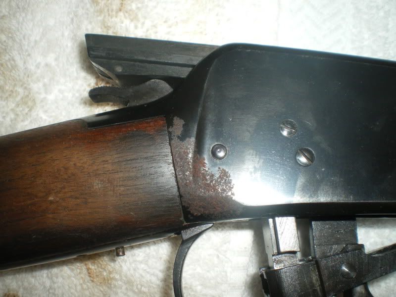

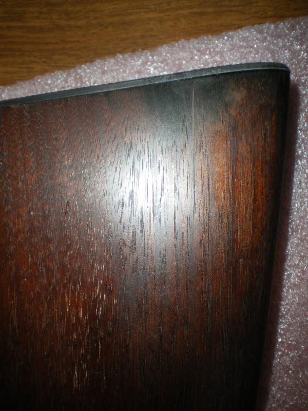

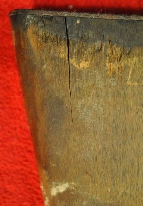

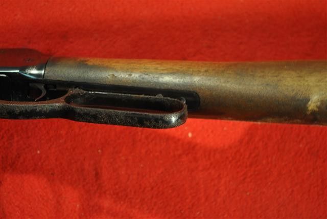

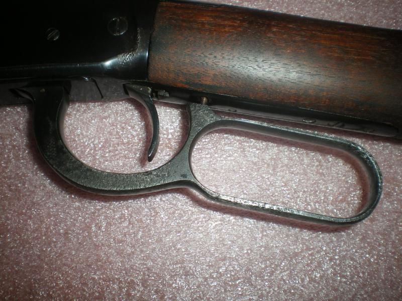

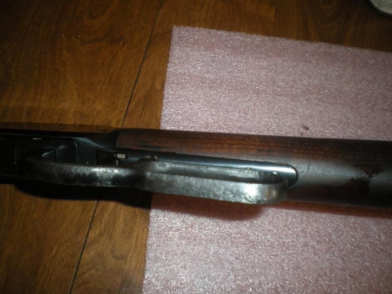

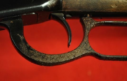

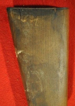

This Win 94 was a rescue project. I won an auction on Gunbroker for this rifle cheap. It was most likely in a flood, where the water damaged the stock/lever and part of the receiver. The damage was mostly cosmetic, except for an area on the stock near the butt plate that needed epoxy filler. I also had to epoxy the wrist of the stock to get a nice fit up with the receiver. I fully stripped the rifle down and put the individual parts that were rusted in an electrolysis bath to remove the rust. The lever was pitted, so I smoothed it over, removing some metal to get rid of the jagged edges, looks ugly but functional. I put a leather wrap on it and is fine. Most of the other metal parts turned out fine. The rifle is a great shooter and actually looks pristine from the muzzle to the stock wrist! Anyhow, it shoots fine for me!!!
BEFORE!
**********************AFTER!**********************************
