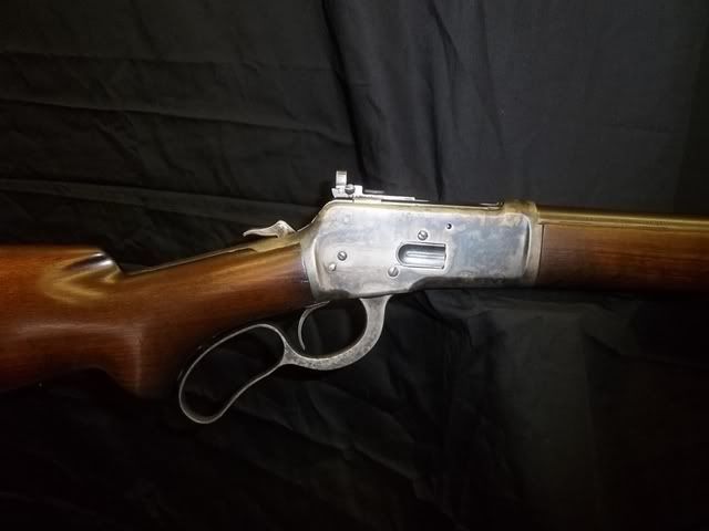

Well I dont know as I traded for it without hearing the full story..I observed that the tube magazine and forearm wood was gone and the loading gate was pried out or possible the tube magazine had been loaded and rounds went off in the fire and with them the magazine and fore end?..But I'm just guessing..I relined the barrel and re-heat treated everything.I said its a model 92 but actually its a model 65 in .218 BEE .Image
