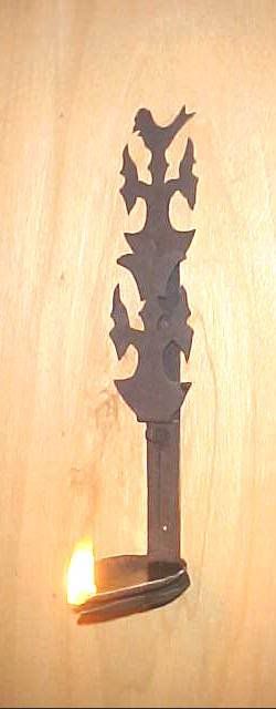

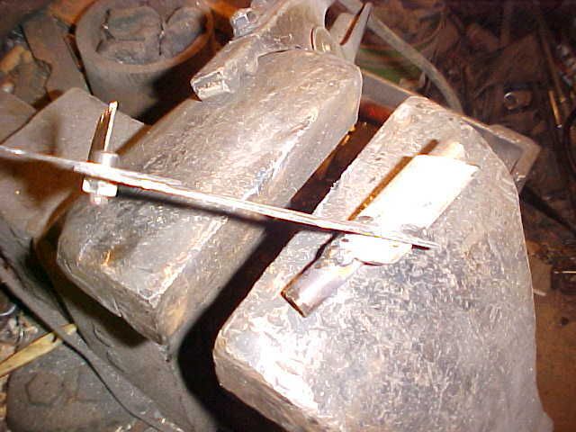

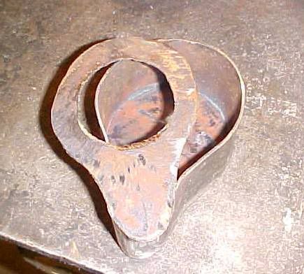

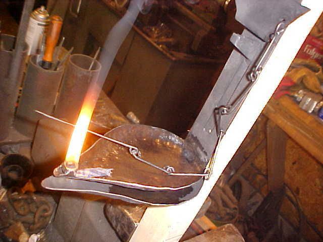

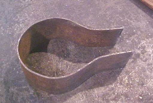

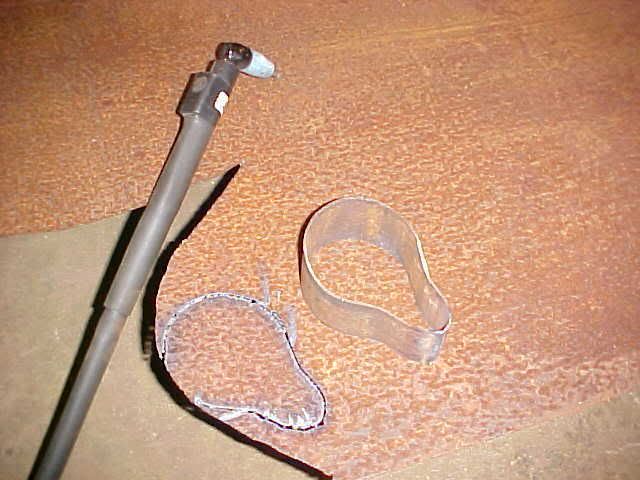

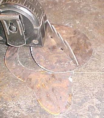

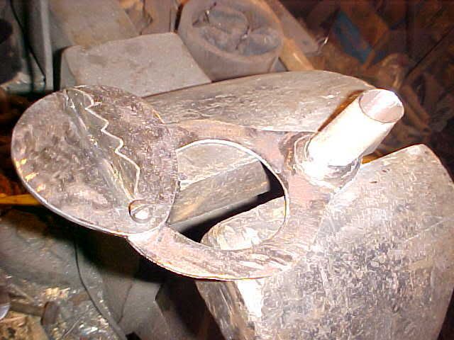

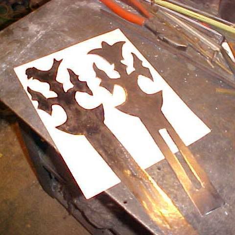

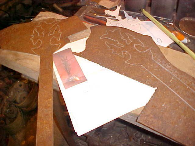

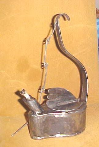

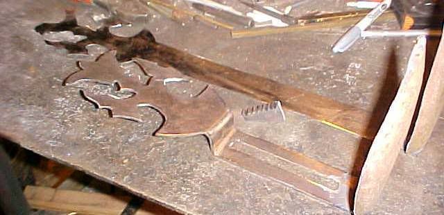

These lamps dade back to the 1700 and are kinda cool, smokey but cool.
The first one hangs on the teeth of the part in the middle and as the oil got low you could tip it forward which would make the oil run to the front, a piece of animal fat would be paced in the pan and slowly melt from the heat.

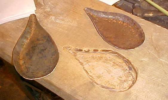

The pan under the top pan was to catch the dripping from the wick, those where made by carving out a psttern in a oak block then hammering the metal into it.

nice.
i like the chickadee finial on the rear piece.

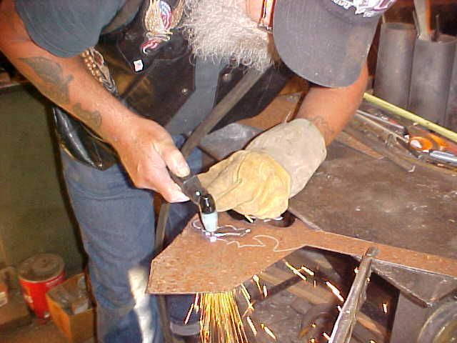

Nicely done.
You can talk about doing some of this work old school. But a plasma cutter rocks!

Just got the plazzy a couple years ago, what a toolwecsoger wrote:Nicely done.

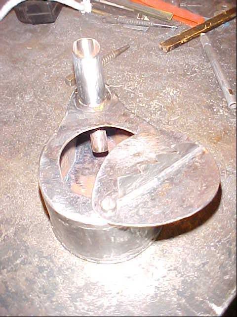

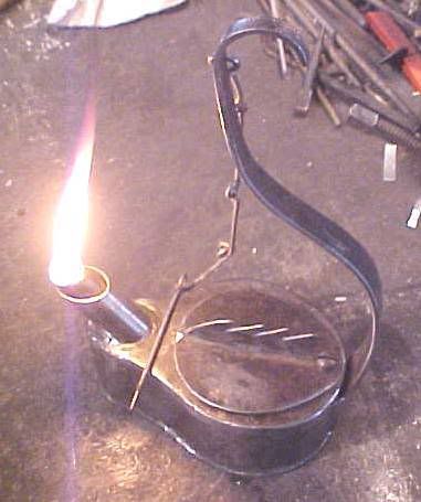

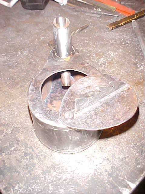

Here`s another one, little more modern.
I changed the design on the lid to make it look more like a swan.

Pretty COOL !!
The wife would kill me! All that soot on the ceiling don`t ya know?

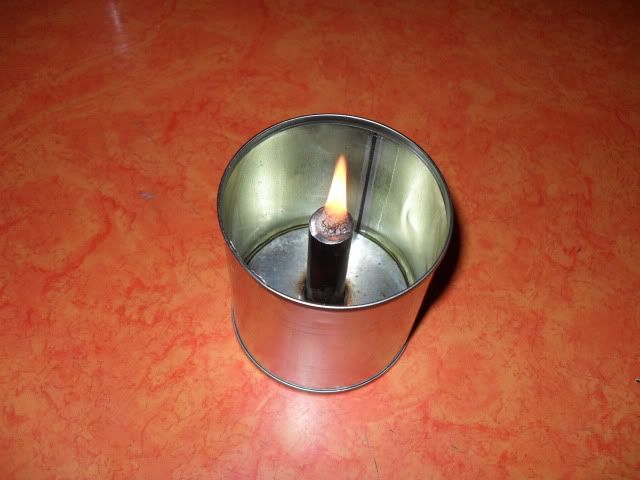

Here's a cool lamp you can make to replace votives/emergency candles in those mini-hurricane lanterns.
It's a 1-1/4" copper pipe end cap with a piece of 3/8" copper tubing soldered into the cap.
(The small tube has 3 "V" notches cut/files into the base. Be careful not to fill the notches with solder.)
Take paper towel and roll it into as tight a cylinder as you can and stuff it down the tube, leaving about 2mm to the top of the tube.
Swage a bit of fine screen down on top of the paper towel.
Fill the cup 1/2-7/8 (don't let it flow over the center tube) with Olive Oil.
While the Paper towel is soaking up the oil, dip a cotton swab (REAL COTTON ONLY) in the olive oil and pull off the head.
Set the head on the screen and light with a match.
It produces a yellow flame that is fairly useful, but sooty smoke. Still, Olive Oil Lamps worked for millennia.

I`ll have to try that, why the cotton on top of the screen?

What i was wondering is why the screen then the cotton on top, i understand the cotton is the wick but why not just a wick from top to bottom. Also will lamp oil work.Pitchy wrote:I`ll have to try that, why the cotton on top of the screen?

Because the cottonball is eventually consumed.
I suppose you could use a full length round cotton wick, but once it burned down to the top of the draw tube it would be a pita to pick out.
Basically you are trying to retain the wicking action as long as possible by not burning the actual wick, only the flame head.

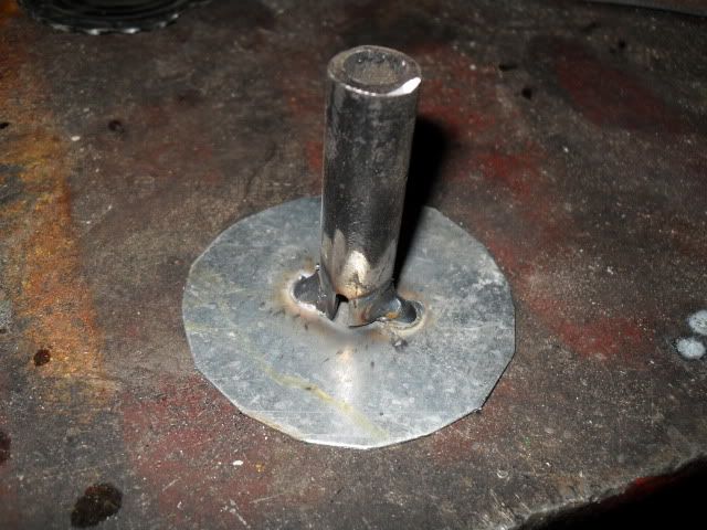

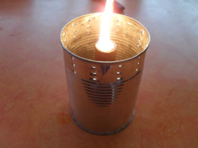

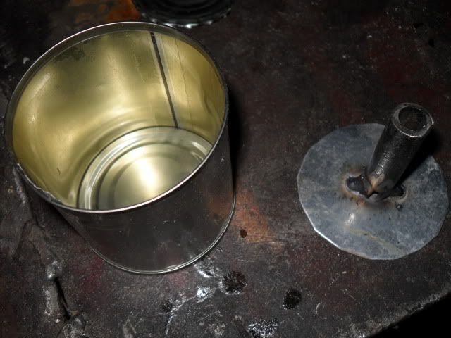

Back from shop seeing i`m a terrible soldering i welded the tube to a tin base that just sits in the can. Used a tee shirt for the wick with the screen on top then a piece of cotton gauze on top.
Burning lamp oil.
Burning lamp oil.

Made another from a pineapple can, little more light and some holes around the top too let a little light out.

Very cool Pitchy.
The biggest reason for the copper cap size is to be able to use it as a Votive-size lamp, but practical is as practical does.
