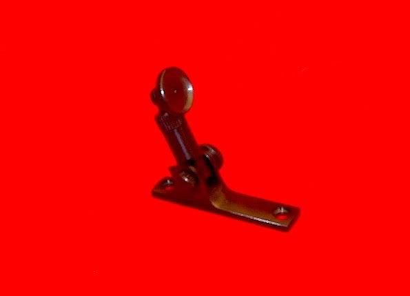

Does the installation of the tang peep sight require drilling any holes or does it fit into the existing ones?

Hummm!! I think one hole had to be D&T'd, I turned everything over to my
Gunsmith and let him put it all together and bore sighted.

[Does the installation of the tang peep sight require drilling any holes or does it fit into the existing ones?]
Most levergun tang sights utilize the existing rifle's rear tang screw hole location to anchor the rear end of the tang sight base, using a longer-than-issue tang screw.
Some sight makers supply the screw, other sell the longer screw separately.
The front end of the tang sight base must also be anchored - either in a factory-prepped D/T'd hole (usually plugged) or in one that must be added prior to the sight install.
When adding a tanger, the rear barrel sight is either removed for a clean sight picture, of changed to a folder so the barrel sight can be zeroed for one distance (usually short range) and the tanger for more deliberate shots at a longer distance - all with the issue height front sight blade.
If you decide to lose the rear barrel sight, most install a slot filler in the open barrel dovetail.

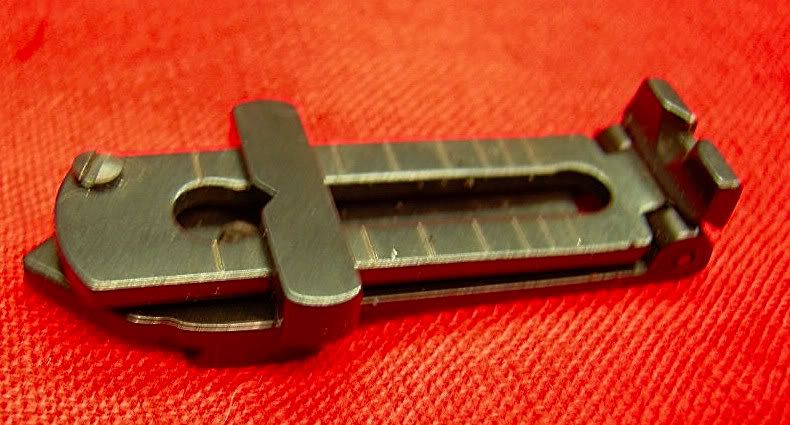

Has anyone installed an original type 92 carbine ladder sight? Does the Browning 1886 carbine sight fit? Someone may have mentioned in this discussion, but what is the dovetail on the B92--Win .375 or what?

Floyd wrote:Does the installation of the tang peep sight require drilling any holes or does it fit into the existing ones?
Thanks.
Hi Bill,
I never recieved the first email but I got the second one. I sent you an email about these sights. Let me know if you got it. If you didn't we may have to PM this.
As for mountining the marbles tang your B-92 is not drilled but I can take care of that. They mount using a longer stock screw and a D&T-ed hole for the front screw. Notice the two holes.

The Carbine ladder sights are available and will work on the late model Rossi's. But, they aren't cheap.
