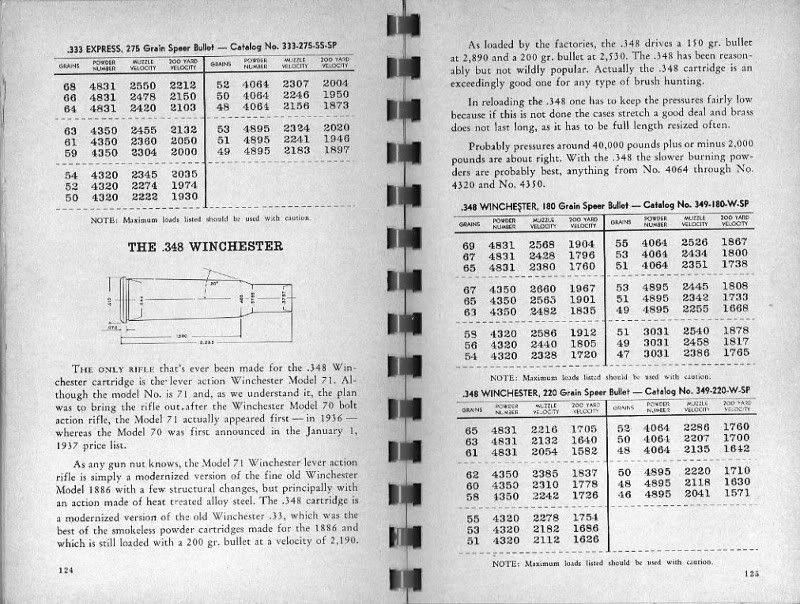

I have a Speer #1 manual. Copyright 1954.
There is data in there for such cartridges as the 348 Winchester. Probably nothing new :roll: or exciting, but I thought it might be interesting to compare it to modern ... 'er is there modern data for that round?
And the old 30-30 that is a milestone cartridge that almost nobody reloads. HA!!!
There's some decent loads for that. Nothing unusual, but I'll be they cause panic amongst some of the "new manuals only" crowd.
If enough of you are interested I'll scan it in and post it. Gotta be more than one though.

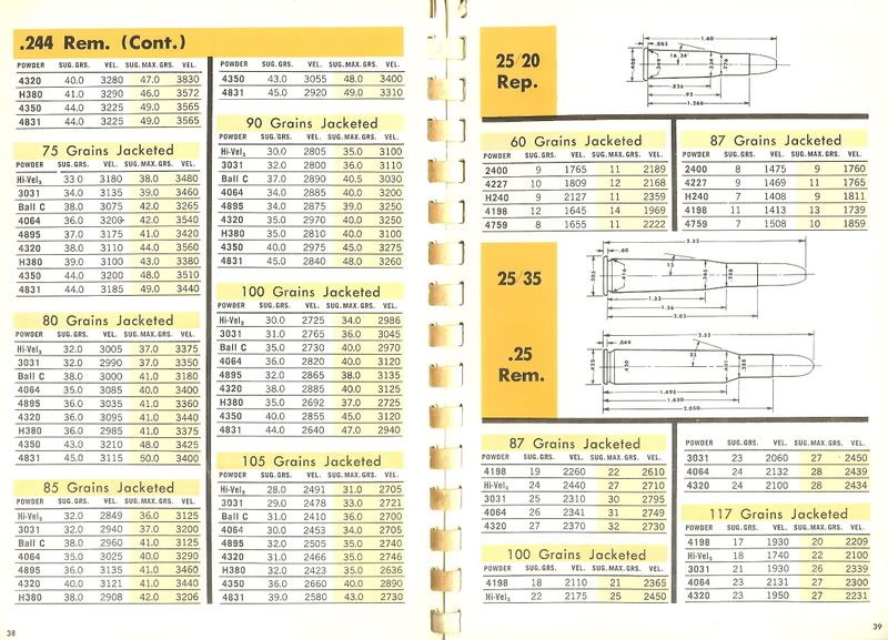

Re: Lever gun load data - Speer #1 anybody interested?
25-35 Win if it is there. Thanks in advance.
Post by Scott Young »

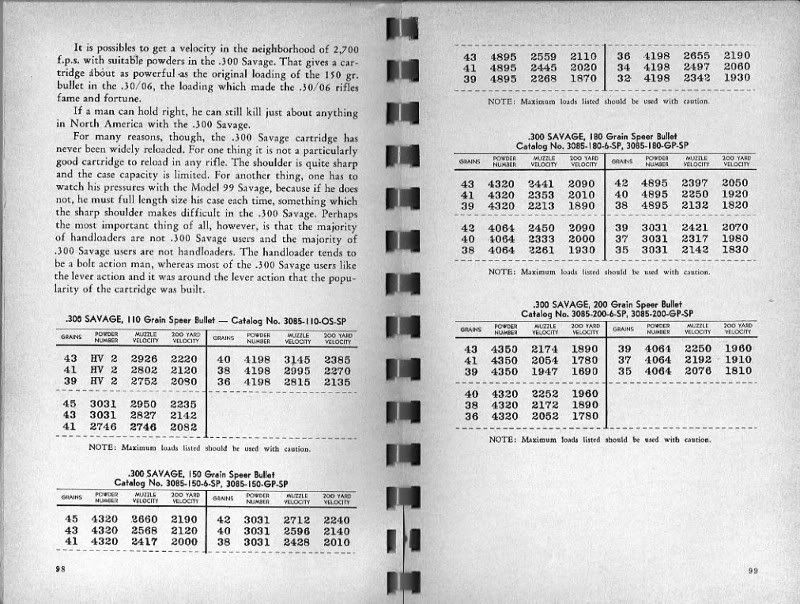

i want to know .30-30, .32 spcl, .44 mag, 35 rem, 25-35 win, and any others you are willing to post. thanks......

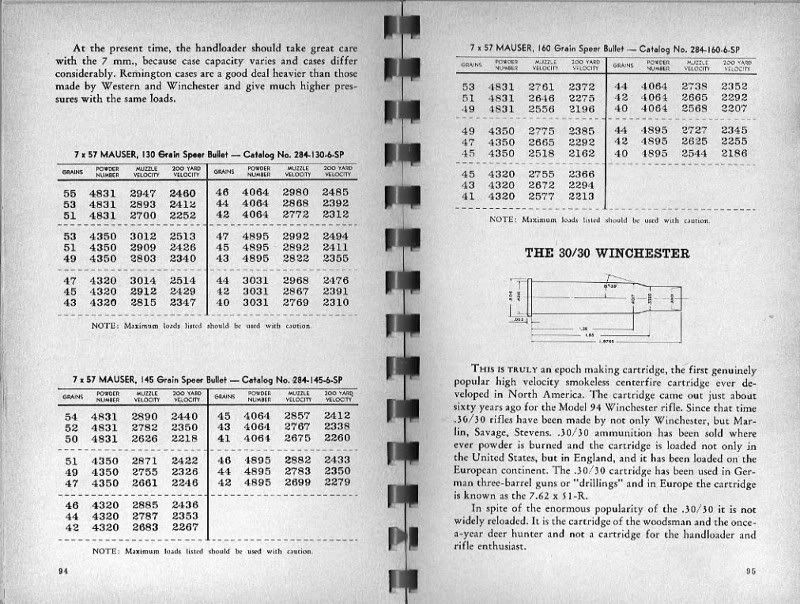

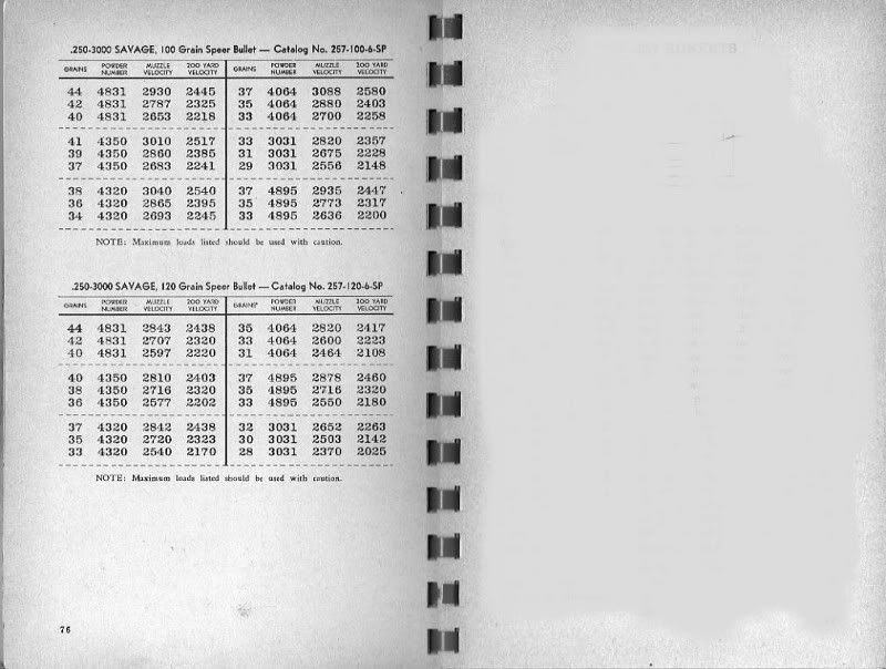

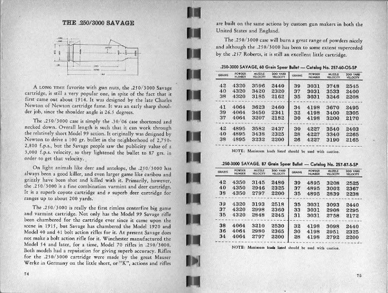

OK, there is no;
25-35, 45-70, no hand gun cartridges at all, 32-40.
Griff, there is no publishing date, only the copyright of 1954.
How about the:
25-3000 Savage;
30-30 Winchester / 300 Savage;
348 Winchester;

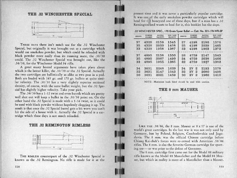

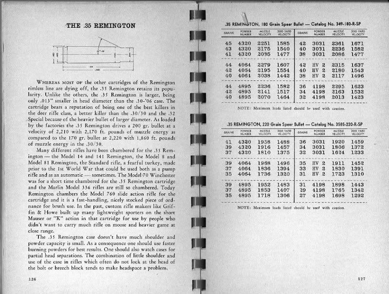

Scott,
Heres the 32 Win Spcl, and the 35 Rem.
32 Winchester Special;
35 Remington;

I don't have Speer #1, but here is some .348 data from Lyman #43. :)
Mike D.

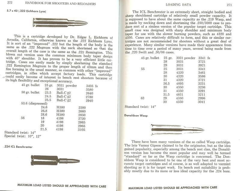

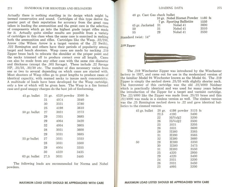

bsaride
Posts: 1268
Location: North Carolina
Post by bsaride »
airedaleman wrote:Need data for the .219 Donaldson Wasp, .256 Newton, .25 Souper, .30 Newton, .333 O.K.H., or the .35 Newton? The Speer Handloaders Manual Volume One has them all and more. I've got a second printing (February 1955) in really nice shape.
Also have Hornady Handbook of Cartridge Reloading (first printing October 1967) also in good shape. $25.00 for both,
mailing included
I apologize for going commercial here. Seemed like a good idea at the time. The commentaries in this manual are really worthwhile. I'm severely computer challenged. Perhaps Joe could post the commentary for the .35 Newton to give the flavor
of the information contained
Minimal load data for alot of these can be found in the P.O. Ackley two volume set.
I don't have access right now but will post something later today to give you an idea
of what data is there.

The PO Ackley books have all but the 30 Newton unless you meant to say 30 Belted Newton.
Some Lyman 43 pages:
