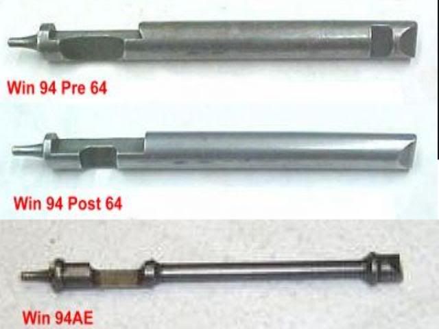

Tycer,
The pre-64 and current firing pins are not the same. Nor are they interchangeable.
Here is a pictorial manage that will show that:

so are the firing pins on the 94AE's better or weaker??? Occasionally i end up dry fireing at the end of a rapid fire shot string if i miss count the rounds.
Re: Help!! Broken Winchester 94 firing pin-update
farmer44mag wrote:so are the firing pins on the 94AE's better or weaker??? Occasionally i end up dry fireing at the end of a rapid fire shot string if i miss count the rounds.
Well, I'll say they are not better, and beings there isn't much metal there they probably are weaker.
My theory is that because of the lighter impact of the rebounding hammer action they went to the lighter firing pin because it didn't take near as hard of a hit to move it.
I do know that my Win 94AE Trapper still has it's original skeletonized firing pin with over 3K rounds fired. And the rebounding action went away long long ago.
