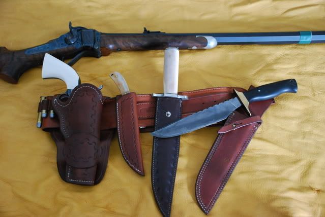

I use the big brown shopping bags you used to get at the store. It's heavier than paper, but pliable enough to work with. As stated already, leave some room for your stitch line and edging. Just don't forget to put your snaps and belt loop on the body of the piece before sewing on the front or you'll potentially travel into sailor territory.
Other than the gunbelt, I made all the other leather.

kimwcook wrote:I use the big brown shopping bags you used to get at the store. It's heavier than paper, but pliable enough to work with. As stated already, leave some room for your stitch line and edging. Just don't forget to put yourand belt loop on the body of the piece before sewing on the front or you'll potentially travel into sailor territory.
Really nice work. Possibly a new line of work after you pull the pin?
Re: OT-Leatherworkers, need a hand please...
Thanks airedaleman, I've thought about doing leather for some time now. I actually made the knives as well. And, the ivory grips on the Colt. Handstitching everything is a pain and it's not very fast. I'd need to pick up a mucho $ sewing machine. But, I'm still thinking about it. Plus, get back into making knives. I moved a couple of years ago and I need to get a shop built.

kimwcook wrote:Thanks airedaleman, I've thought about doing leather for some time now. I actually made the knives as well.
Really good looking work there! And you've hit on another hobby I'd like to do... :wink:
Posts: 28823
kimwcook wrote:Thanks airedaleman, I've thought about doing leather for some time now. I actually made the knives as well. And, the ivory grips on the Colt. Handstitching everything is a pain and it's not very fast. I'd need to pick up a mucho $ sewing machine. But, I'm still thinking about it. Plus, get back into making knives. I moved a couple of years ago and I need to get a shop built.
Where's that darn "jaw-dropping" smiley? The slobbering one too? :mrgreen: Dang, that is good work all the way around! I bet you'd get steady work just from this website!

kimwcook wrote:Image
Why the green tape on the barrel? :?
Must be because it is an environmentally-friendly Sharps! :wink:
The green tape is to mark the resonance node of my barrel. Black powder cartridge rifle (BPCR) shooters shooting Sharps modeled rifles have found, debatable subject, that shooting off cross sticks that there's a resonance node located somewhere on your bbl. Alot of them mark that area with something, tape, whatever..and place that mark on the cross sticks for the best accuracy. Placing the forearm on the cross sticks isn't as accurate. Hence, the tape on my bbl.
Now, you know, the rest of the story.

kimwcook wrote:The green tape is to mark the resonance node of my barrel. Black powder cartridge rifle (BPCR) shooters shooting Sharps modeled rifles have found, debatable subject, that shooting off cross sticks that there's a resonance node located somewhere on your bbl. Alot of them mark that area with something, tape, whatever..and place that mark on the cross sticks for the best accuracy. Placing the forearm on the cross sticks isn't as accurate. Hence, the tape on my bbl.
Thank you Mr Harvey! :lol: Actually, that's pretty cool since I never knew that!
