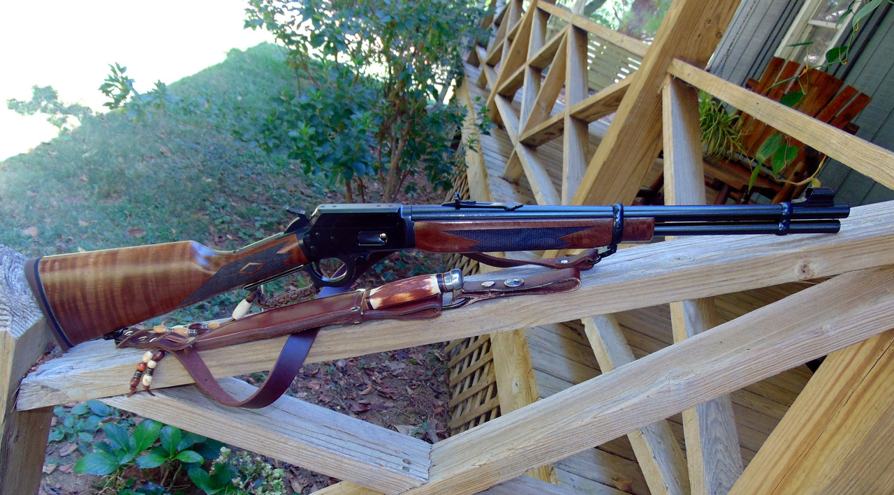

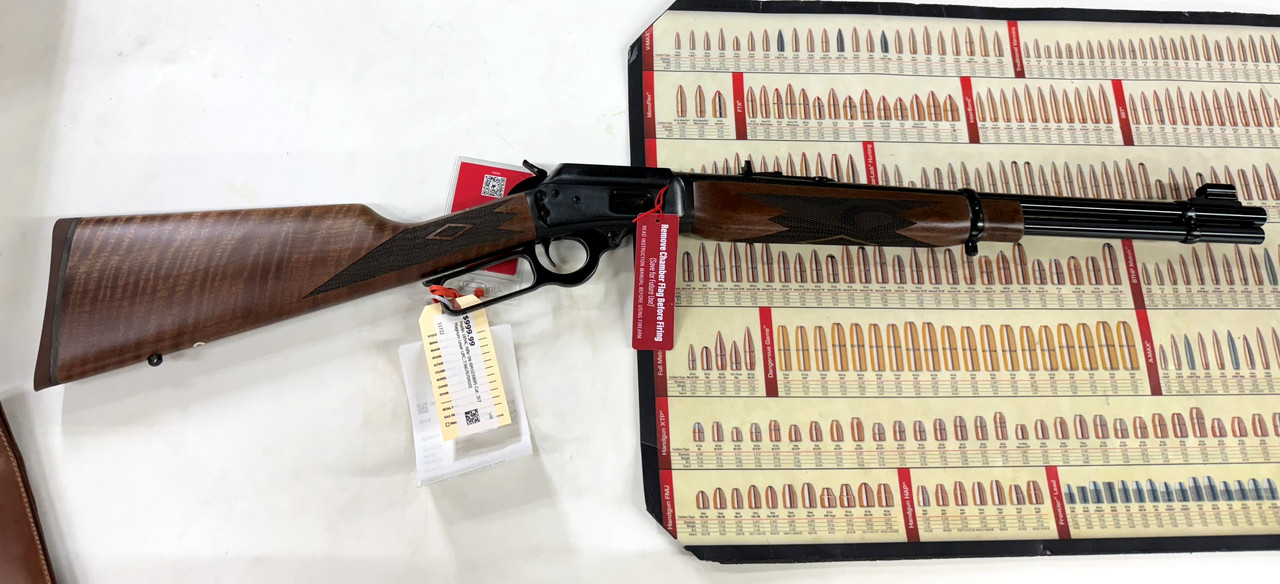

Picture will say it all. Glad I was there to get this one. In Jail and will take me a little while since gun money is low due to buy my Rossi 1895 45/70 and my Winchester 1886 45/70. Then this pops up. Can't wait to let it loin my Rossi R92 in 357mag.

Nice find , I don’t like to spend that much without selling something , but that would have been in the car on the way home.

I really have nothing I want to get rid of. So it's time to take the slow process on this one. Plus keeps the wife happier.

Very nice... :mrgreen:

That's a pretty one. I've been dreading running across one of the new 357's since it'll probably go home with me. I'm even more worried (for my checkbook) that they might decide to make some in 32H&R! :lol:

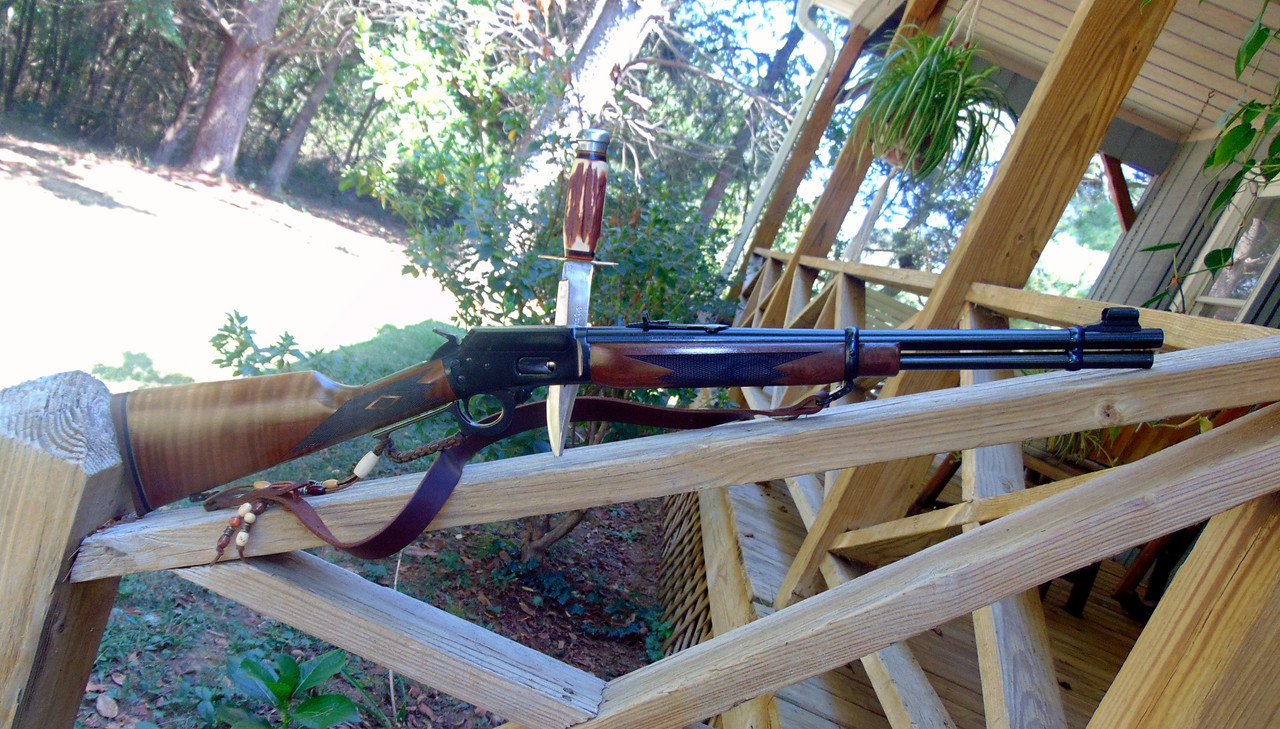

Post by jstanfield103 »
Some better pictures of her with the saddle ring safety delete installed.
