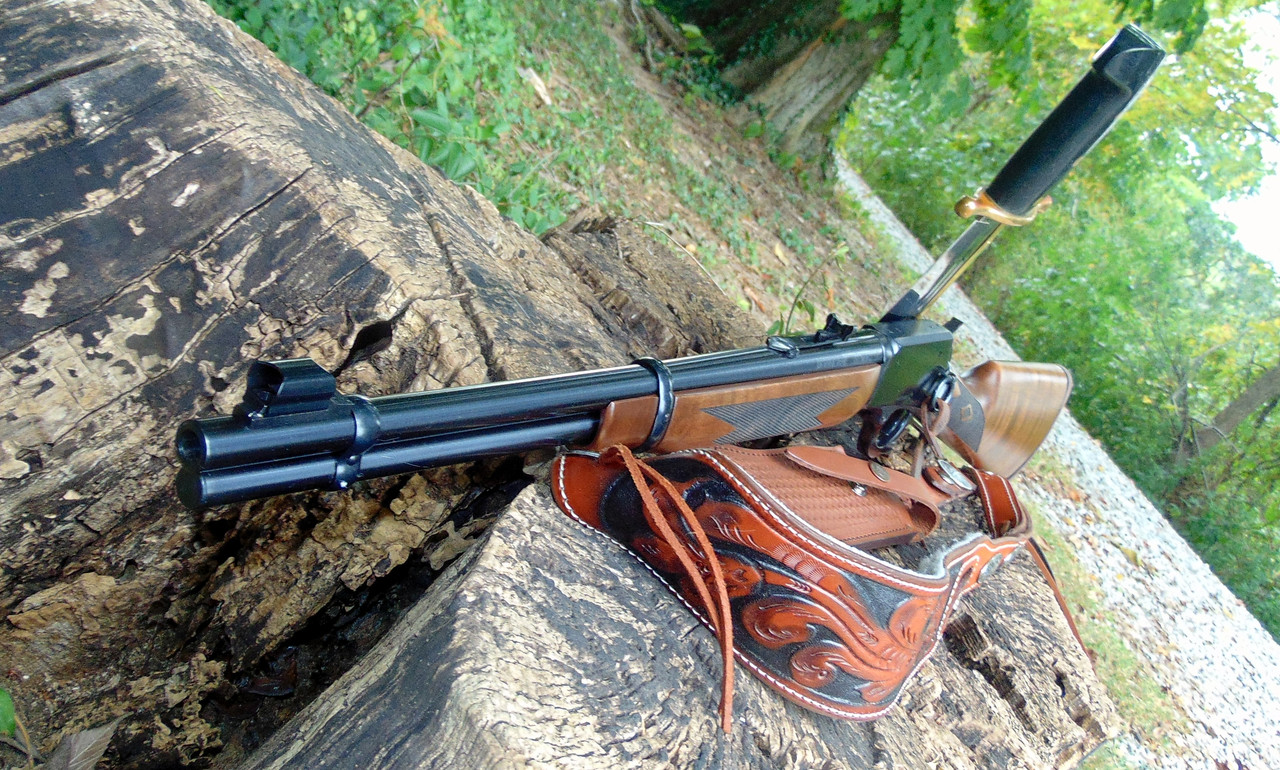

Picture will say it all. Glad I was there to get this one. In Jail and will take me a little while since gun money is low due to buy my Rossi 1895 45/70 and my Winchester 1886 45/70. Then this pops up. Can't wait to let it loin my Rossi R92 in 357mag.

Nice find , I don’t like to spend that much without selling something , but that would have been in the car on the way home.

Very nice... :mrgreen:

That's a pretty one. I've been dreading running across one of the new 357's since it'll probably go home with me. I'm even more worried (for my checkbook) that they might decide to make some in 32H&R! :lol:

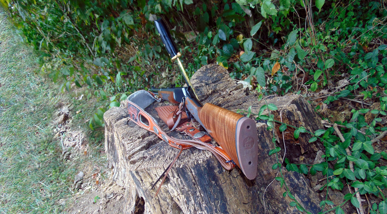

Here is the butt Pad after corrected fitting. Happy with it now, in fact extremely happy with the fit now.

That one didnt stay in "jail" long !
looks good ! - love the tiger stripe figure on the buttstock -
I have a shotgun project i still need to cut the LOP down on -- you're posts are giving me inspiration to get with the program

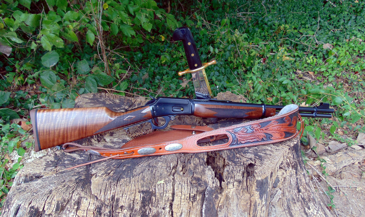

Some better pictures of her with the saddle ring safety delete installed.
