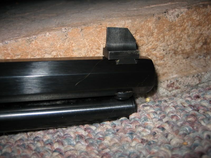

wildmanh, Skinner sells a great post front sight for I think $10.00
I never tried it with the stock front sight.
The Skinner front sight was tall and I filed it down to keep it and the rear sight as low as possible with my 180 gr. load.
Before
After
If I was guessing I would say you will probably have to use a taller front sight.

Joe, I did it myself with a checkering file. It would be a nice touch if Skinner would do it to them though. Like wildmanh said he is a nice guy to deal with and he just might?
