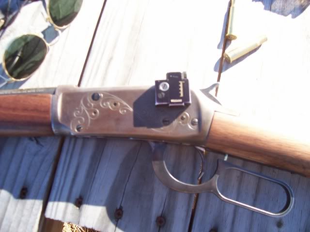

This is a top view of the Williams sight. Most guys prefer them to open V sights for better clarity and ease of sight adjustment. Typically, once zero'd, the sights remain true indefinately.
