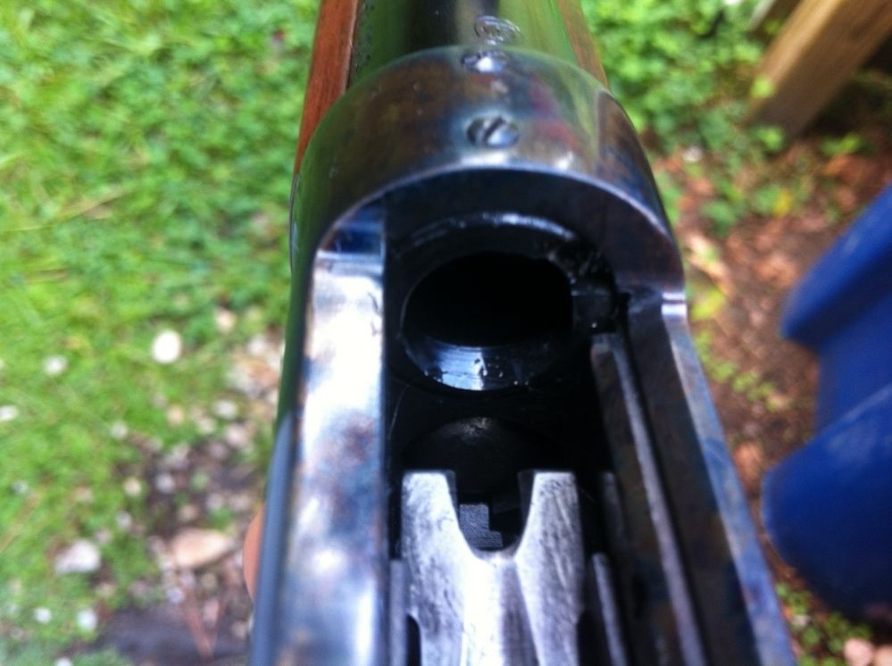

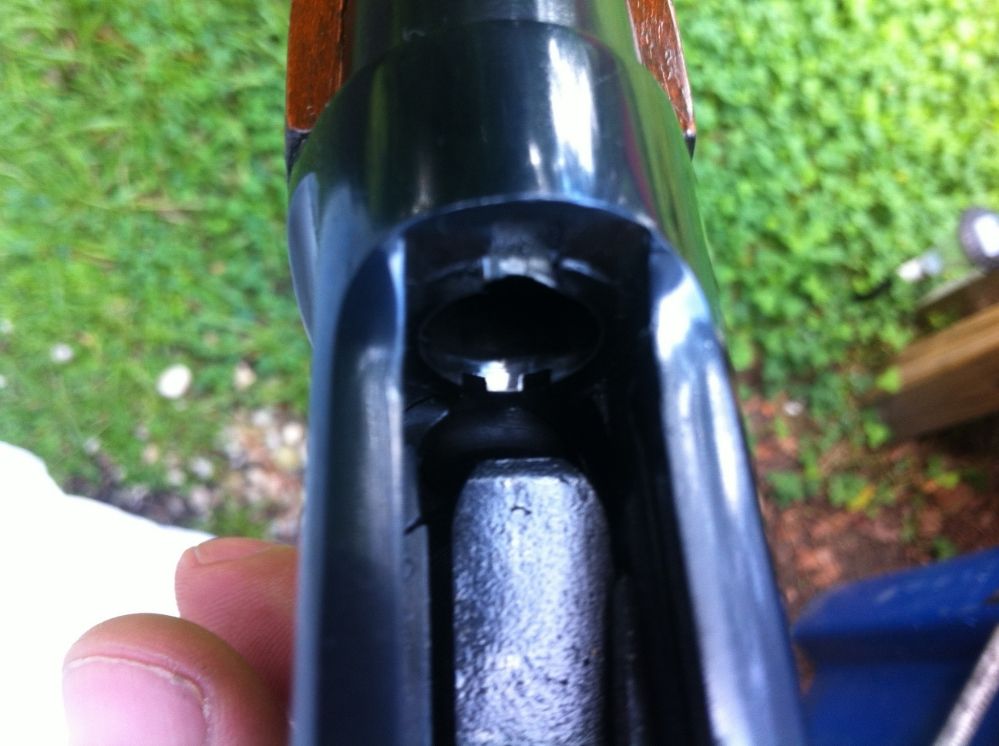

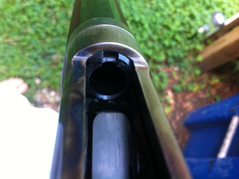

How much is too much is a matter of degree. Here are three examples of factory ramped .45 Colts.
Here is the chamber on an Armi Sport Model 92 takedown:
Here's the throat on a Rossi 92:
And here's the throat on a Winchester Model 94:
The Rossi is middle of the road, while Model 94's chamber is pretty aggressively ramped. The Winchester however handles Ruger only loads just fine with no bulging of the brass. That's pretty much the weather gauge of when it's too much. carefully examine the brass to ensure there is no bulge corresponding to the ramped portion of the chamber. In the extreme, with overly soft brass, excessive pressure and an excessively ramped chamber you can get this:

Thank's for the pictures and responses. I spent the other day at the gun club shooting it with .38 Spec. 158gr. LSWC and factory .357 Magnum loads. The beveling/throating/chamfering of the chamber is causing bulging of the case in the web area. The chamber is more egg shaped, off set to the 5 o'clock position and extends farther into the chamber than Model 52B's photos show.

One of the major attributes of the Model 92 is that it is a very strong action (it handles .454 Casull just fine at the SAAMI spec of 65,000 psi) and it would be unfortunate for a poorly throated chamber to compromise that strength.
I will normally see a very slight asymmetrical bulge on .45 Colt cases fired in my Winchester - very subtle but there - that is not evident on the same loads fired in a Blackhawk, and it's never been an issue. But if that .357 is bulging cases to any significant degree, I'd return it.
