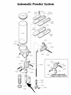

Thanx guys. I got to play with the press a little, and found that the expander die is undersized for .38spl. I was getting no flare on the case mouth, and it was shaving lead. After several attempts to adjust the die, with no improvement, I got out the mics and found that the expander was only .355" dia. No way to make that work. I will contact Dillon this week to get the proper part. It can load the plated bullets I have with no problem. I will also ask about converting to .45acp. That will be expensive, I'm sure. I found this press to be much more difficult to adjust settings with than my Lee Classic Turret, but, such is life.

Did Dillon say it was the wrong expander? Seems odd it couldnt be adjusted, all expanding dies should be able to make a flair.

I'm not as familiar with the SDB as the 550, but on the 550 the flaring happens at the powder drop station. Did you test that?

Good deal. Aye, the case mouth flaring should be at the powder dump station. The flaring is done by the part that slides up and down inside the body of the die portion... (I'm sure I'm not using the proper nomenclature). You probably just need to drop the powder measure down some more, as the expander should have a flange further up to actually do the case flaring.

Thanx Griff. I ran the die down until only one adjustment thread was left, and finally got a flare. Now, the primer tube does not want to feed properly, and the powder measure actually started to throw very inconsistent, and lighter and lighter charges, until it quit dropping powder all together! It looks to be static from being stored several years in it's plastic shipping box. I took the hopper off and wiped it down both inside and out with several drier sheets, which seems to have helped that a lot. Now the primer tube does not feed properly. The primers either fail to drop, or just disappear. I finally noticed primers falling out the side of the nylon primer feed. Some were fine, others mangled. Gotta check this out now.
There are many little plastic "beans" inside the storage box, as well as some deteriorated rubber from somewhere. I am guessing a very good cleaning, and de-static job, may solve most, if not all, the problems. But, right now, it is starting to drive this old man nuts. Well, actually too late for that, since that happened a long time ago.
Guess I need to spend some more "get to know you" time with it.
