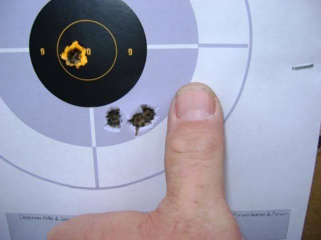

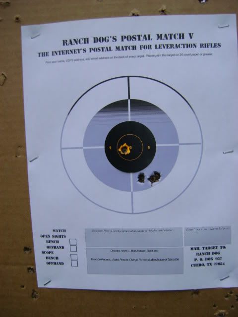

Been working a few days on this .270 Winchester load and I must say it's a fairly easy round to load for. And I had fun doin' it to boot! :D The final load worked out as:
Once fired Winchester brass
150 grain Nosler Partition
Federal 210M primer
54.9 grains of Reloader 19 powder
3.375" OAL
Chrono'd at 2861 fps avg SD 12 ED 37
The best part is that it's ACCURATE.......... :o
http://i231.photobucket.com/albums/ee26 ... ing001.jpg
http://i231.photobucket.com/albums/ee26 ... ing003.jpg
3 shots in 1" @ 200 yds !!! ........and I'm not that good of a shot !! The fourth shot is the final scope adjustment. He has exactly 40 rounds now to practice and hunt with. WHEW ! I'm glad that monkey is off my back........ :lol:
Thanks, Tom
