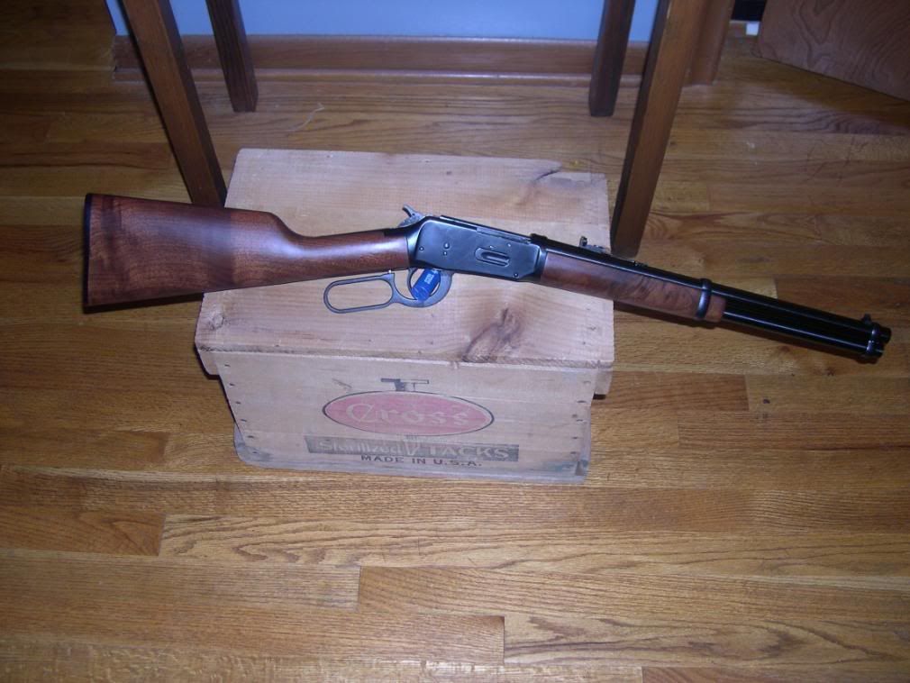

The good thing is that all of my Rugers (Bisley Hunter, Bisley Blackhawk, Bisley Vaquero) all also like the 240 grn xtp and the MT Baldy Keith style 250grn over 18.5 grns 2400. Good, because I added this little beauty to the herd last night
It was NIB unfired and still wearing it's original packing grease. Not anymore :wink: Pre-safety angle eject but it does have the 1:38 twist. Had a short range session with it today and it did pretty well with the 240-250 grn bullets. It also was accurate with the 300s but I only shot those at 25 yards so hard to say how they would work at greater distance.

Posts: 21455
Re: 44mag barrel twist rate experience
3T, that's great lookin' wood on that Trapper. As someone said about my .30-30 Trapper, bet that has some kinda BARK! :P
