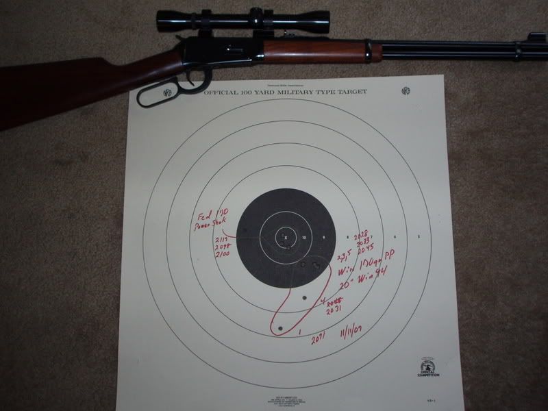

Posts: 16960
Re: Your Favorite .30-30 Recipes, esp for 170's.
Federal Power Shok :) 2100 fps. And the X ring in my 30-30.
