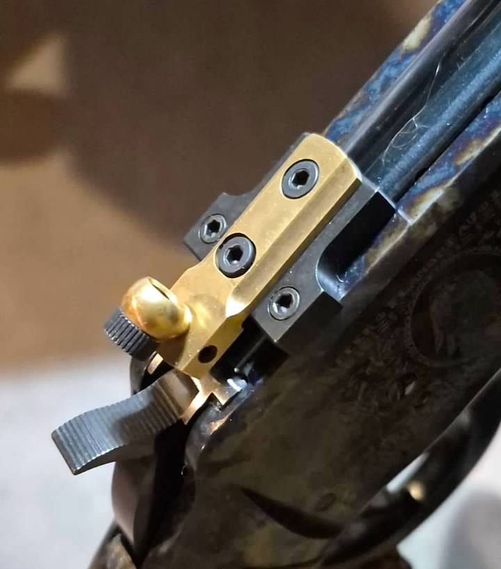

Veeman, it looks like you have a Skinner sight on there. How is it mounted?veeman wrote: ↑Thu Feb 05, 2026 10:53 am I used my Crazy Horse this past season with success! I used Barnes ..377 bullets with 2400 powder. That was the main reason I bought in NIB, new barrel, no bs lawyer safety's. I do wish it had an octagon barrel, the thin round barrel gets purty hot after a few shots. But it shoots great and fun to hunt with.
[/quote]
I had this and both my Browning 1886's D&Ted for these Skinner sights. I don't think they are being produced in this style anymore. I called their shop to get a 2nd one for my 86 src but no go so still on the lookout. I have this style on a couple other 94's. Had to have it shaved down a couple thousandths as it shot too low. Now perfect.
[/quote]
Veeman, thanks for posting this close up of the Skinner sight.

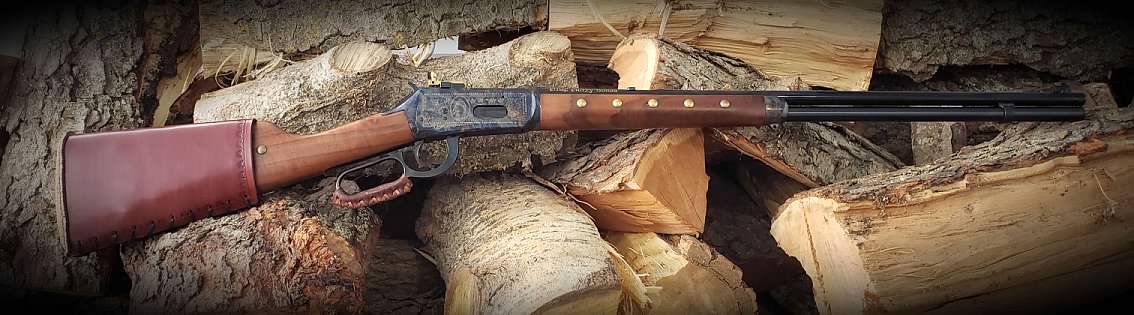

We need pictures!!!!
