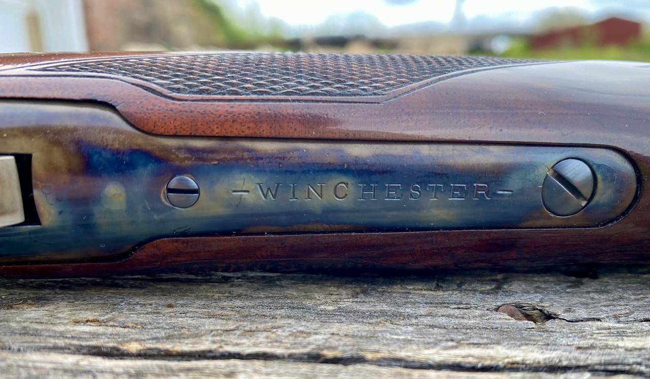

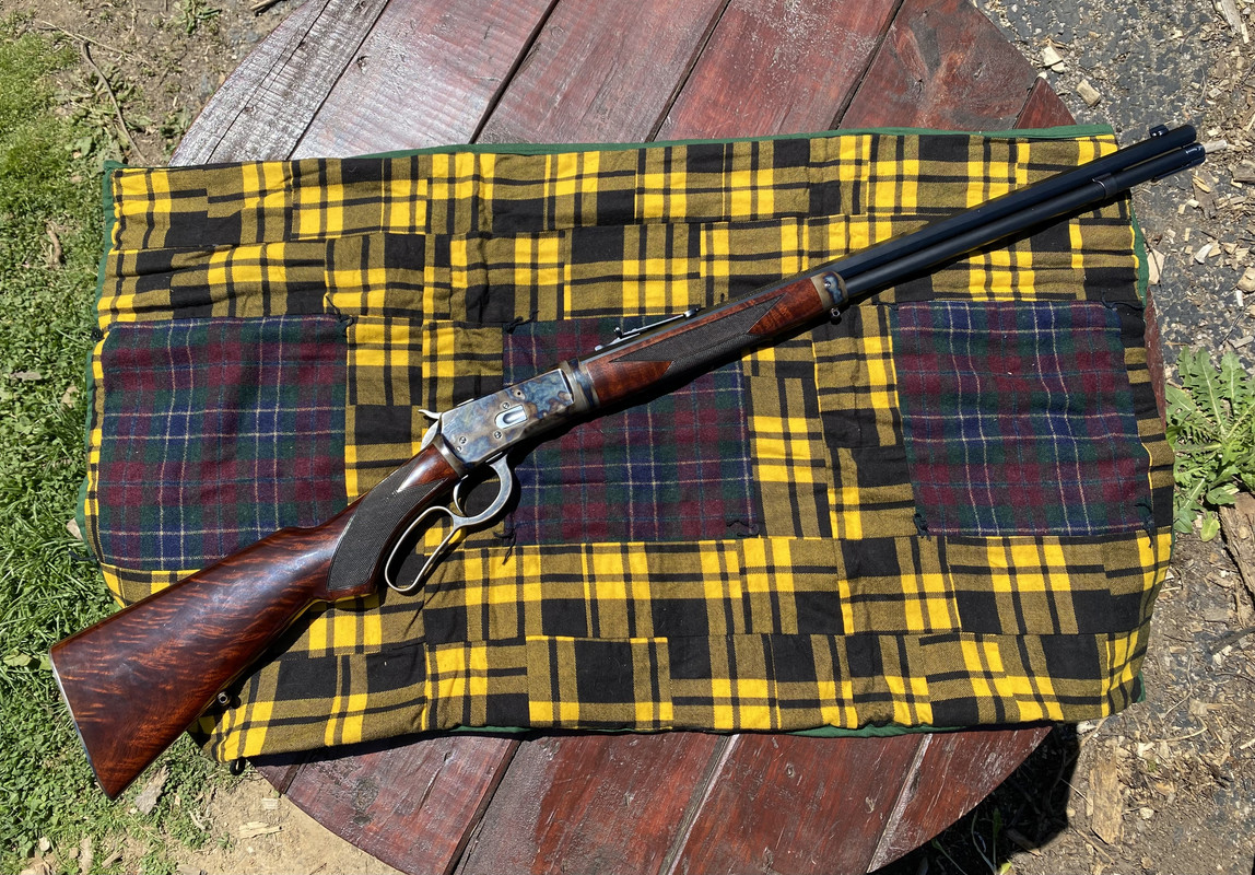

My Winchester 1892 44 Magnum has a 1:26" twist. I haven't tried a lot of bullet weights yet, but it seems to do well with standard and heavier weights. I do have some lighter bullets to try, I just haven't loaded them yet. It won't chamber the Lee C430-310-RF though because it has a short throat. I would expect the 45 Colt version to be short throated as well.
My rifle will feed any bullet shape including semi-wadcutters, as long as the length isn't too long. It will accept just a touch longer bullet reliably - .020 longer than max, if memory serves me. It will feed Specials with semi-wadcutters just fine too. It won't feed full wadcutters in special brass (I haven't tried them in magnum cases yet), but I didn't expect it would.
Mine is reworked and refinished by Turnbull.

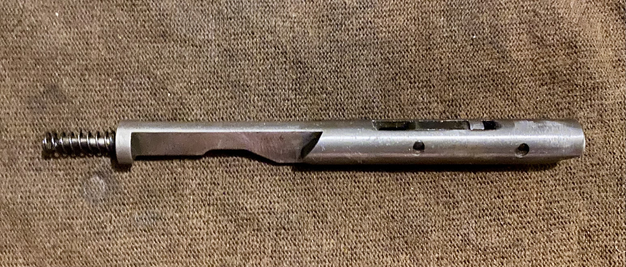

Turnbull fixes the safety and converts it to half cock notch.High Desert Hunter wrote: ↑Mon Apr 21, 2025 11:49 am Thank you! All of the rifle options have the lawsuit safeties, I wish they didn't, but they do and I negate them on my Marlin rifles, not sure how a guy would "fix" the Winchester.
The firing pin has been welded solid and all of that firing pin block nonsense has been removed.

Levergunner, just wow! That is beautiful! I'd hate to see what that would run a fellow these days! Walt, I have heard that 300 grain bullets will shoot from these Marlins, I also know that Ruger is getting ready to release the 1894 Classic soon, and rumor has it the barrel will have the same twist as the revolvers. The one I am looking at is a clean Cowboy Carbine with a 20" barrel, who knows, if they ever release another run of the Cowboy models a guy might be able to get a faster twist if he wanted. I wish I had the financial wherewithal to buy all 3, but the real world just says no, blessed to have what I have, and to even be able to think about something new.

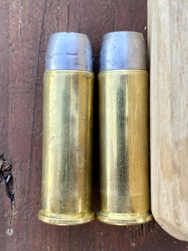

I have a B-92 in 44 mag. Rifles made to SAAMI spec have larger diameter barrels, a slow twist (1 in 38”) and quite a long throat (0.22”). My B-92 has all these features. SAAMI has a different spec for pistols, so you might struggle to find a cast load that works in both rifle and pistol.
I’ve found the best cast bullet accuracy in my rifle to generally be when I use as wide a bullet as will cycle and chamber in my rifle. What this does is centralise the cartridge in the chamber. This means a pill around 0.432-0.433 in diameter.

THAT IS AWESOME!LeverGunner wrote: ↑Mon Apr 21, 2025 11:35 am My Winchester 1892 44 Magnum has a 1:26" twist. I haven't tried a lot of bullet weights yet, but it seems to do well with standard and heavier weights. I do have some lighter bullets to try, I just haven't loaded them yet. It won't chamber the Lee C430-310-RF though because it has a short throat. I would expect the 45 Colt version to be short throated as well.

Thank you very much.RIHMFIRE wrote: ↑Sun Apr 27, 2025 5:34 amTHAT IS AWESOME!LeverGunner wrote: ↑Mon Apr 21, 2025 11:35 am My Winchester 1892 44 Magnum has a 1:26" twist. I haven't tried a lot of bullet weights yet, but it seems to do well with standard and heavier weights. I do have some lighter bullets to try, I just haven't loaded them yet. It won't chamber the Lee C430-310-RF though because it has a short throat. I would expect the 45 Colt version to be short throated as well.
