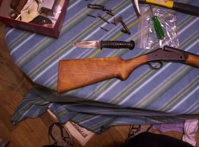

Before.....

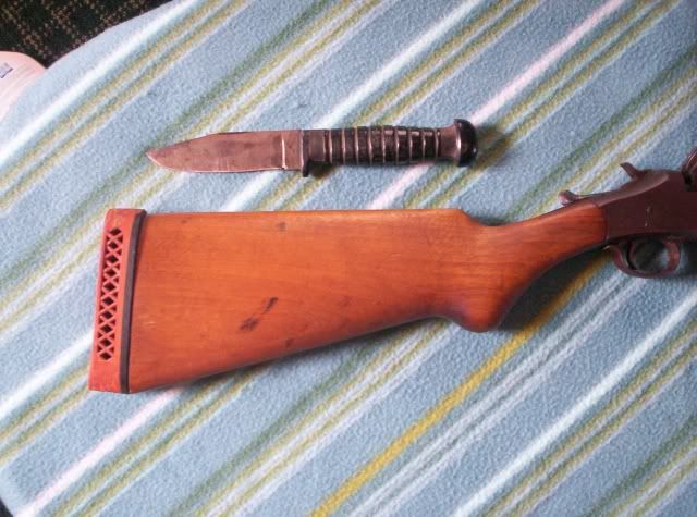

.....After.
It still needs to be fitted w/ a new recoil pad, but it already looks a lot better.
