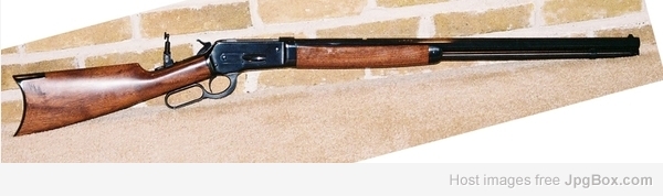

Welcome to the 1886 45-90 crowd.
I bought a new Winchester 1886 45-90 because it provided both the 45-70 and 45-90 and I am very pleased with the performance of both cartridges in the US and Africa.
The 90 performs well up into the .458 Win Mag range and it takes all African game (ele, buff, leopard, etc) cleanly with one shot.
