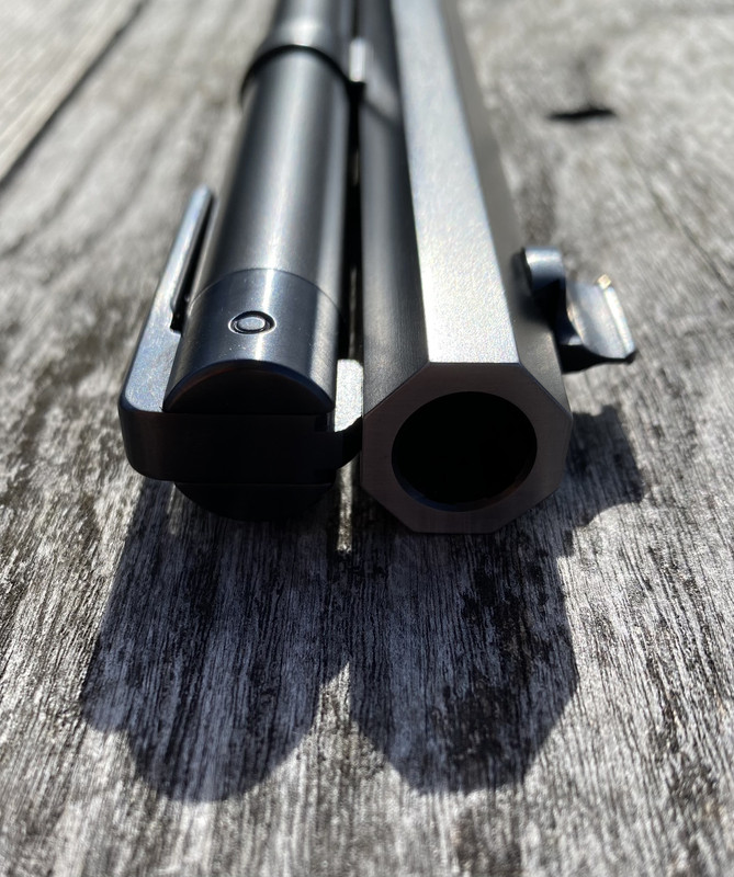

I am no expert, but I have a new 1886 and a new 1892, and I've been researching the guns and the takedown system as a result.
This picture is from my new 1892, but they used this system on 1886s, 1892s, and 1894s.
I'd say a gunsmith removed the takedown lever and knurled the end.
As for rear sights, anything that the customer wanted would be substituted in place of the standard, which was called the Sporting Rear sight and was semi-buckhorn.
