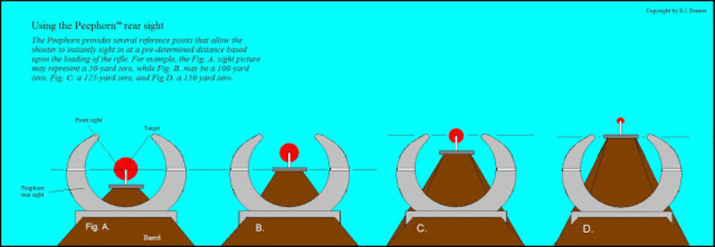

Me, buckhorn sights and bifocals, ugh.
First, with the buckhorn, I'm starting to realize that the front sight has to be down deep in the rear. True?
Second, I bought a Skinner Post, just the one with the peep and no base with the Marlin size (8X something) screw.
Thinking if I screwed it all the way down it would work with the existing front sight. Nope, not close.
It will only go in about half the length of the threaded shaft.
So before I do something stupid like shorten it, will shortening it work or do I still need to change out the front sight,
Do these still work with a hooded front sight ? Is the base required?

The Skinner Lo-Pro peep sights can work, but the front/rear sight heights above the bore C/L must be close to even in order to zero the rifle.
The Lo-pro can be used with the locking ring removed from the stem, but before shortening the stem I would suggest using a long straightedge spanning the tops of both the existing front sight and the rear sight, extended back over the top of the receiver to determine how high above the top of the receiver the line-of-sight is.
That measurement should tell whether of not the Lo-Pro will work if lowered, or if your rifle will need a new front sight blade approx. 0.10" taller than the issue front sight blade.
Do these still work with a hooded front sight ? Yes
Is the base required ?
The Skinner Lo-Pro doesn't have a base, instead utilizing one of the scope mount prep holes atop the receiver.
I hope that helps you. :)
