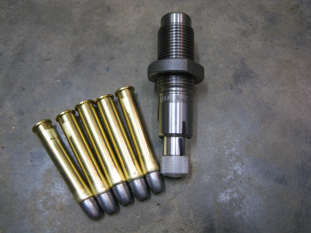

Re: Need Help With Loading 38 55
Everyone else above gave excellent advice.....I purposely left out option number 3 as it is taken by some to be in poor reloading practices, but I've been doing it for over 40 years with probably a dozen 38-55 rifles over the years accounting for ???? thousands and thousands of rounds. I feel so safe in this, I regularly shoot this "style" out of Winchesters & Marlins that are worth serious money.
My solution to using the needed diameter bullet in a rifle that will not accept that needed bullets? Use 30-30 cases or cut down your 38-55 to expanded 30-30 length. Seat the bullet out to correct overall length.
Your not gonna hurt your chamber...no different than using 38 Spl in a 357 or .22 short in a L.R. chamber. 38-55 pressures are low and won't eat the walls of the chamber.
The reason this works is because the tightest part of the chamber is the first 1/8"-1/4" of the chamber mouth...usually just th first 1/8". By eliminating the mouth of the case by that much you are freeing up space for the fatter bullet.
This 1893 Marlin, takedown, in 38-55 was like new when I got it but the colors had faded. The previous owner/owners must have had it where the sun shines on it. I took the receiver and other needed parts and shipped them to Turnbull for recase. This rile has a .379 groove diameter and will only accept a.377 bullet but with the aforementioned procedure, it shoots! I regularly use it in competition and has since digested 2200 rounds since the recase.---6
On expander dies...we all know that the Lyman M dies are made for the cast bullet shooter and are usually better than the expanders that come with a set of dies designed for jacketed bullets.
A guy, who is picky about his dies and wants the absolute very best..(not me, if it shoots great, I stop) :D will make his own for a specific caliber or like me, will fish around in the hundred or more dies I have laying around to get the best. For an instance, when shooting at our cast bullet matches, I'll use a 700 Remington in .308 but I'll use the expander from a 32-20 or 303 British die.
Sometimes at gunshows a dealer will have a cardboard box full of dies..all mixed up, different brands, rusty, whatever and I'll say, "how much for the whole box?" Him, wanting to unload the junk will say, for instance, "$75" and down the road I go.
Sometimes I'll chuck the expander die of.....once again, for example, a 41 mag in a drill press and spin it down to .407 for the 40-65 or 40-82 Winchester that normally come with a 404 expander. (Don't hold me to these exact measurements)
Expanding dies are more important to accurate cast bullet shooting than most people realize. Target and hunting ammo requires different expander sizes..usually. :D ----6

The Winchester is a good shooting rifle, did not shoot any groups but it worked well off hand at 40 yards shooting plastic bottles.
Going to stick with the 10 grains of Unique load as it's pretty mild and everyone seems to enjoy shooting it.
If I can get the loading gate sorted out it will be a regular shooter as it's lots of fun.
Thanks again to everyone for their help.
Shasta, thanks for the tip on the brass length and will keep that in mind if I run into an issue.

One thing you may or may not know is when loading through the gate only push the cartridge 3/4 of the way in unless it’s the last one. This keeps the fighting to a minimum.
