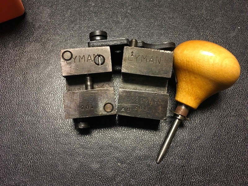

Post by 6pt-sika »
Paid a bit to much , but I got a Lyman 429215 HP mold . Already have a two cavity 429215 and 429244 as well as a 429244 HP . I kinda like the smaller HP of these molds over the bigger HP like on the 429640 Devistator or the big pin in the NOE molds . Hopefully this one will work relatively well in my 44 MAG Contender and perhaps 444 rifle . Already had success on deer in the 444 using the other three molds mentioned so certainly shouldn't be any reason this one won't do also 👍🏻 https://i.ebayimg.com/00/s/MTIwMFgxNjAw ... PM/$_3.JPG

Post by 6pt-sika »
Got the 429215 HP mold as well as a single cavity 429434 I bought as a backup to another I have just like it !

Post by 6pt-sika »
AJMD429 wrote: Thu Apr 20, 2017 12:08 am You'll be able to make nice deer-getters from those flat-points, for sure... 8)
How do you think the hollow point ones will perform....? Outside of factory loaded 'Silvertips' in my 44 Special, I've only shot jacketed hollowpoints.
I've already killed deer with the Lyman 429244 HP and it has the same HP just 30 or so more grains of bullet weight . So it's my assumption that this one "should" do about the same .
