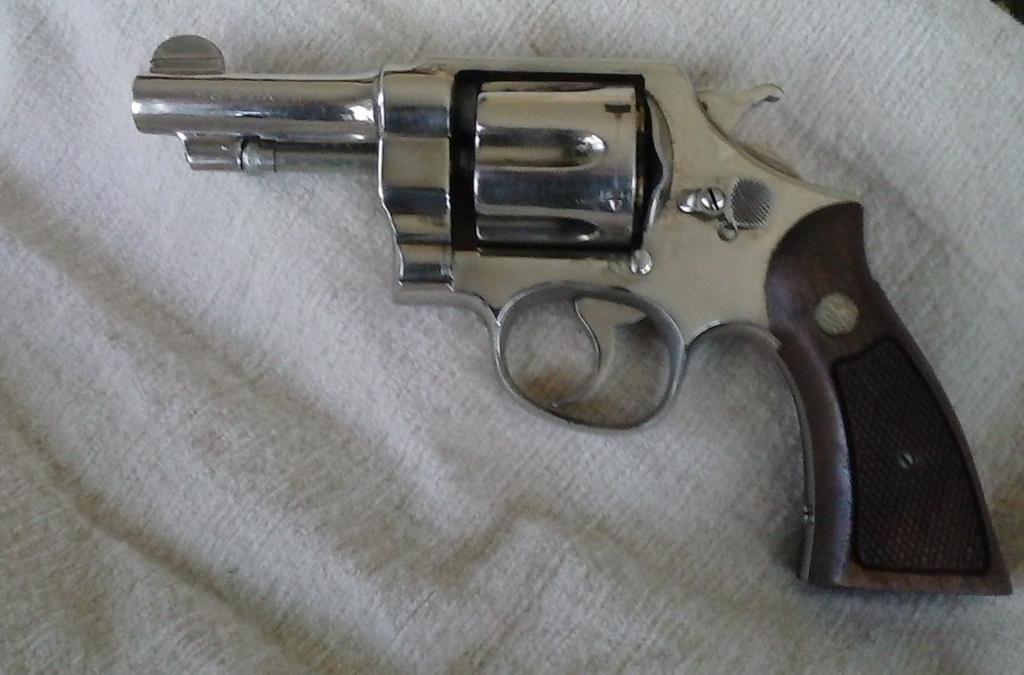

Blaine, this is my old 1917 that someone modified to what I think is perfect. 3.5 inch bbl. It now wears a Tyler T grip adapter.
Most of it's shooting is with the 200 H&G semi-wadcutter over 5.5 HP-38 but for social purposes I like the 200 XTP over the same charge. I think 200 grain bullets are easier on the gun and me. I'd have no hold backs on shooting a whitetail within about 35 yards.
