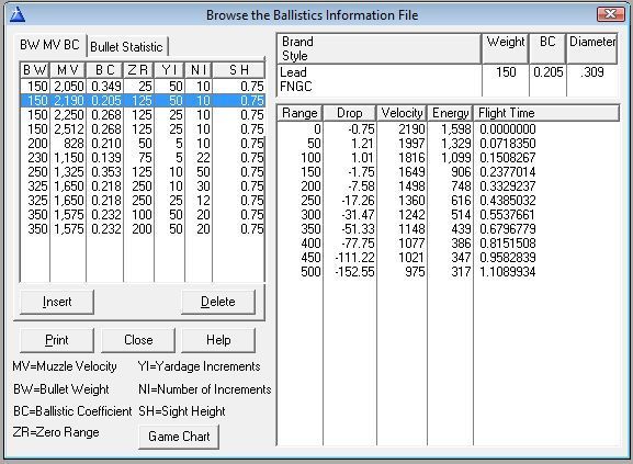

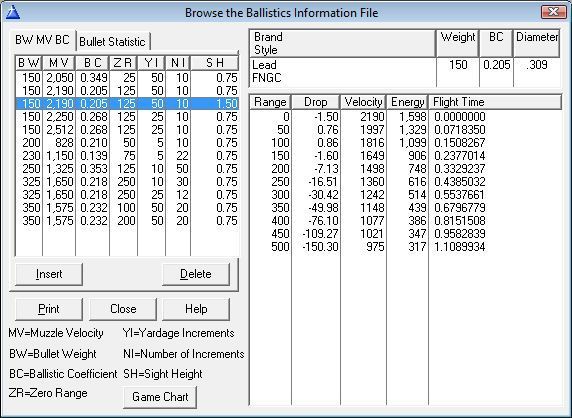

A little high school arithmetic gets you the correct dimension. Measure the outside dimension of the barrel at the front sight. ½ of that is the centerline of the bore. Measure from the top of the barrel to the bottom of the dovetail in the ramp. Add those two numbers and subtract from .75 to get the sight height you need.
Just as tall scope mounts will increase the variance between line of sight and line of bore, so too will too tall of a sight. Thus, adding to the difference in line of sight to actual trajectory. Making adjustments for both short range and long range more extreme.
It's always preferable to have the line of sight as close the center-line of the bore as practicable. ¾" allows for adequate accurate sighting at the apex of the trajectory, while still allowing enough rear sight adjust with factory sights for longer range sight. I don't have a graph readily available to demonstrate, but... on my .30-30 say, that ¾" above the center of the bore allows me to have a rather large "zero" range, (where the bullet stays within a fairly narrow margin along my line of sight. I.e., the distance the bullet travels that it remains within, say 2" of the line of sight). The higher the front sight, the shorter that range will be.
As compared to a chart showing a sight height of 1-½":
Admittedly, the incremental difference is quite small, as even at 500 yards, there is only a 2.2" difference in line of sight vs trajectory. For precise shooting at unknown ranges, or if you're like me, not the best of range estimators, I want all the variable factors in my favor!
