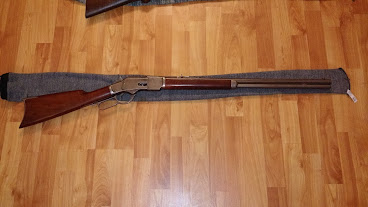

Sorry, forgot to mention my 1873 is a .45 Colt version. I bought it with a set of 1858 BP revolvers and a Bond Arms Derringer all in .45 colt so I could reload the same cartridge for all of those. I sold the 1858s and plan to buy a set of Ruger Vaqueros. BP and I didn't really mix well LOL, but I may still try it again.
Here is my Uberti 1873 .45 colt with 24.25 octagonal barrel and antique finish:
