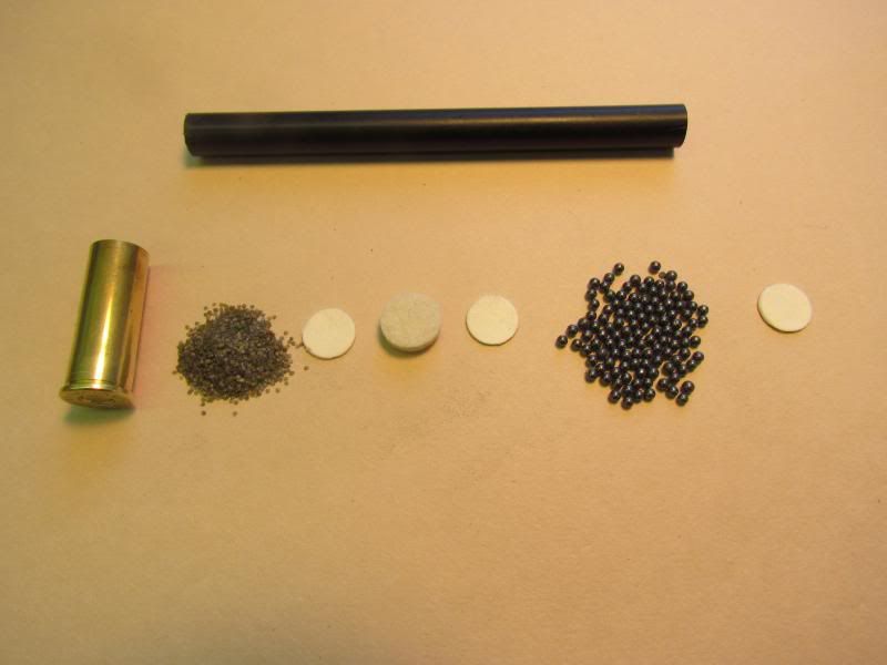

A friend asked me if I could load some shot loads for his .44 mag.
This morning ,while waiting for the Turkey and fixins , this is what I came up with.
They look like they will do the job.
Case full length resized but not belled or expanded
Case primed with standard primer.
6 gr. Bullseye (suggested load from CCI manual for their shot capsules)
Milk carton wad
Ox-Yoke brand .44-.45 caliber "Wonder Wad"
another milk carton wad (all seated hard on the powder)
aprox. 150 gr. #8 shot
Milk carton over shot wad
Crimped in my Lee factory crimp die.

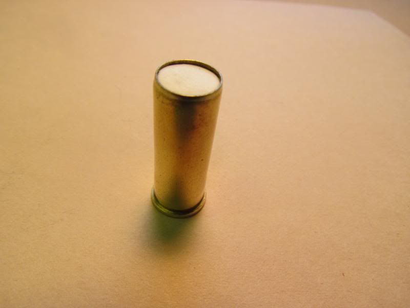

These things I made are absolutely devastating. These particular ones are loaded in 44-40 cases and I shoot them out of an original smoothbore 1894 Marlin, but I guess they could be used in anything 44-40. They contain 160 grains of #11 shot.
And if you don't use them for anything I guess you could get a 54 caliber round ball and use them for bowling. :D ----6

Next to the 44-40 shot load, you will see these other weird looking rounds. Many years ago when most guys here were still in their diapers, I read an article in the American Rifleman on shot loads from WW2 that the airman kept with their 1911's for survival. Well, I was just a punk kid then but I had good genes so I knew how to think and just by looking at the pictures, I said to myself, "I can do that".
So........I took some .308 empties and cut them down and then used a (iirc) a 38-55 fls and made my very own shoulder. These babies will feed 100% in my Colt's Government Model but are not powerful enough to operate the action by themselves so I have to rack the action myself. I made about 25 of them.
This is what I have left and these are the exact ones I loaded 35 years ago.----6
