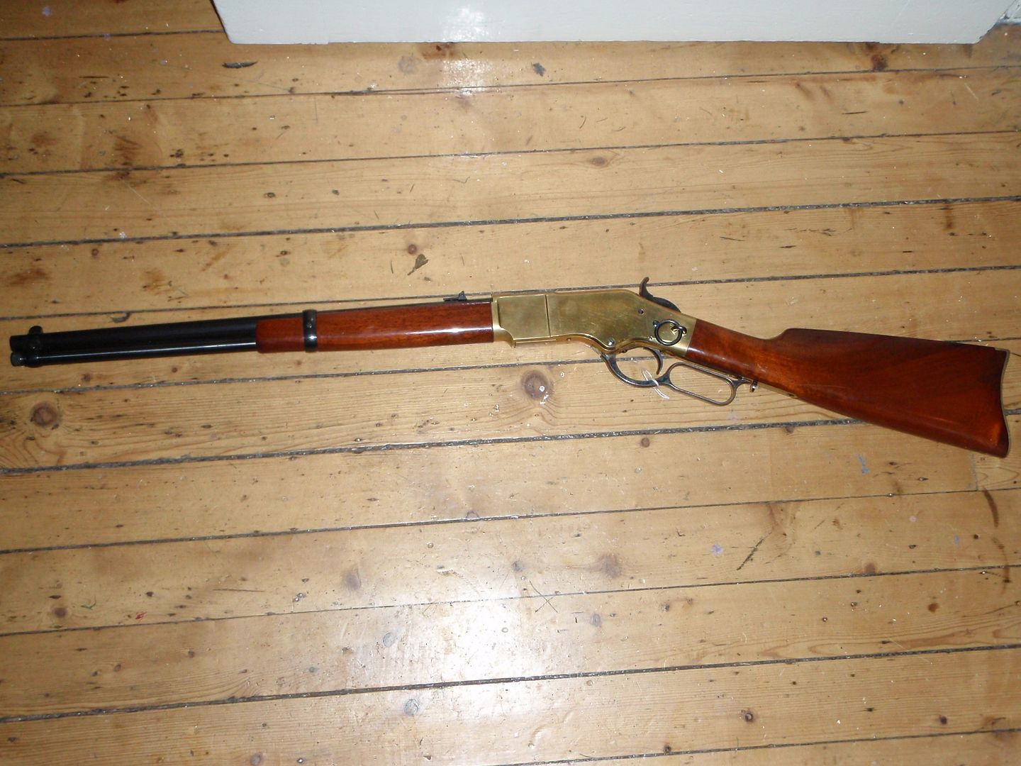

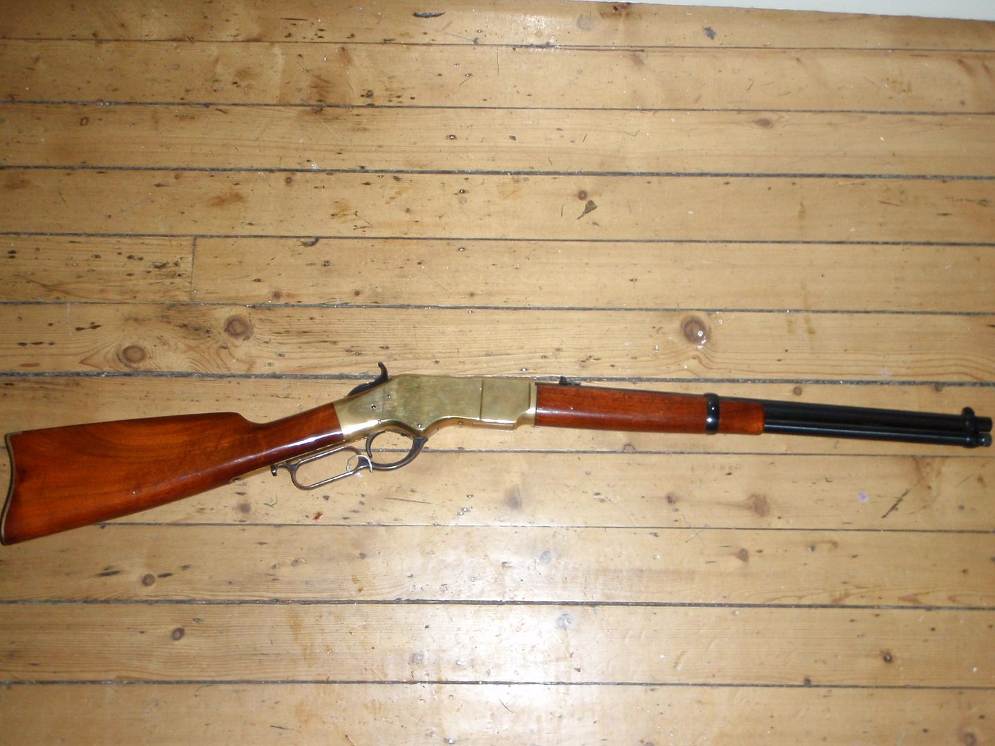

I took my Yellowboy .22 WMR out for a rare walk in the woods today, there was nothing about so I did a bit of plinking. The sights, as I've said before are abysmal, especially in dark shade, anyway by just guessing where the front sight was I managed to hit a tin can and a couple of .410 shells. When I got out into the sunshine I could see the sights OK but they still leave a lot to be desired. I took a couple of shots at the end of a log and both shots were touching, OK the range was only about thirty yards or so but this rifle has been always accurate even at longer range, if only it had better sights I would use it more often.
Anyway, what I would like to know from other Uberti Yellowboy or Henry owners is, how do get the brass to tarnish evenly so it takes on a more antique look?

Use some black powder fouling on a damp rag, quickest thing I know to tarnish brass.
Re: Uberti Yellowboy Carbine.
GK, although there's a multitude of methods out there for giving brass a patina via soaking the brass in tea, etc - IIRC, all involve removing any overfinish (lacquer, etc) from the brass.
http://pyracy.com/index.php/topic/18365 ... s-quickly/
The absolute best way is to simply wait - the brass will tarnish naturally over time (usually a few years, as in the case of my frontstuffers).
The pic looks like your rifle's well on it's way to a natural tarnished/brownish finish - which I prefer to the black finish that results from some of the methods. (like maybe using BP fouling on a patch ? IDK, I never tried that.)
On one BP rifle that had a multitude of bright brass, I applied a light coat of cold blue to the brass, letting it set foe a little while before wiping the brass dry w/rag (more will turn the brass black) - which resulted in an immediate, CCH-type tarnished finish that actually was quite attractive (IMHO - YMMV).
I'm sorry that I didn't keep any pics of the cold blue result, but I deleted them after I sold the rifle.
Maybe you could try it on a non-visible brass area of the receiver of your rifle, or on some other shiney brass piece, like an empty cartridge case.

Most brass will have some type of lacquer or other protective finish, it it is gone, it will tarnish. A soak in the right solvent may work, or removing it with an abrasive, either way the coating needs to come off. Once that is done, you can speed the tarnishing with vinegar (get it on the bluing and it will take the bluing off as well, be careful) or buy wiping cold blue on lightly and wiping it right off. Go kind of dry and easy if you use cold blue as if it goes on heavy it will turn it black. Or just take it down to bare brass and let it take a patina naturally.
ETA: If you use any kind of abrasive, make sure it is done in a way that does not leave even sanding scratches all the same direction in the surface or it will look sanded.
