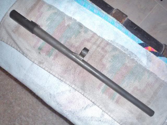

Based on this thread...I got some of this product and tried it on a VERY rusty shotgun bbl that had been given to me from a junk metal bucket, stored outside, behind Old West Guns in Kearney, NE. If I hadn't seen it work with my own eyes..I wouldn't have believed the results of just a few hours soaking.

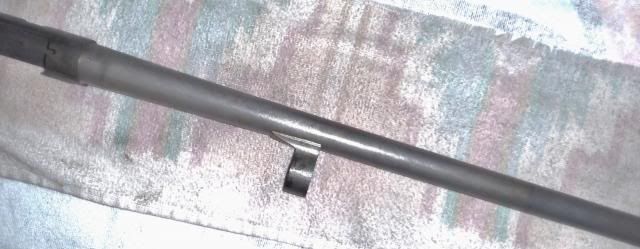

FWiedner...Here ya go. Unfortunately, I was in too big of a hurry to snap any before pics, but imagine a steel shotgun bbl stored outside in the weather, an overall bright ORANGE in color.
Pretty much takes it down to bare metal. Now some polishing and a little cold blue and my new 19" bbl is ready to go on my Rem. M-11.

Over in the shop smith forum they like Evapo- Rust also. A member soaked a drill chuck that looked like it was retrieved from the bottom of the ocean, it cleaned up as new. It does seem to etch the metal into to a matte gray color. Good Stuff.

I noticed one thing and that it appears that its not the thing to use on guns or gun parts as it evaporates bluing by the pics of guido4198's barrel. The color of the metal looks the same as it does after using Naval Jelly or phosphoric acid, (which is an ingredient of Naval jelly) that gray color.

It surely DOES take off blueing as most blueing is an oxide and that's what Evapo-Rust is after. And regarding pits it will dissolve the rust all the way into the pits down to bare metal, but you'll have to brush & rinse away the altered rust (think tooth brush) to get the pits cleared out.
I'm not sure if it "etches" iron and steel to that gray look or if that's actually a deposit placed on the metal in the process. What I've noticed is that it burnishes out very nicely with steel wool, but some of that gray color remains and it can be a nice look depending on the work in progress (think of a Ruger Super Redhawk in the gray finish). I've also noticed that parts soaked overnight in Evapo-Rust take to cold blue like a SPONGE if you just rinse them off in water and plunge into the cold blueing solution. I favor Brownell's Oxpho Blue for cold blue work, and I've had items come out nearly pitch black after Cleaning with Evapo-Rust and then dropping in the Oxpho. It's pretty amazing.
