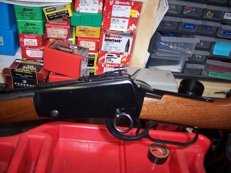

I put the new Hi Viz front sight on my Henry .22. Has anyone used the bullseye rear sight - I don't know what it is called? How about a dovetail groove mounted peep? Do these replacement rear sights work with the front sight height? Any other thoughts on sight changes? This is the model with the barrel band front sight.

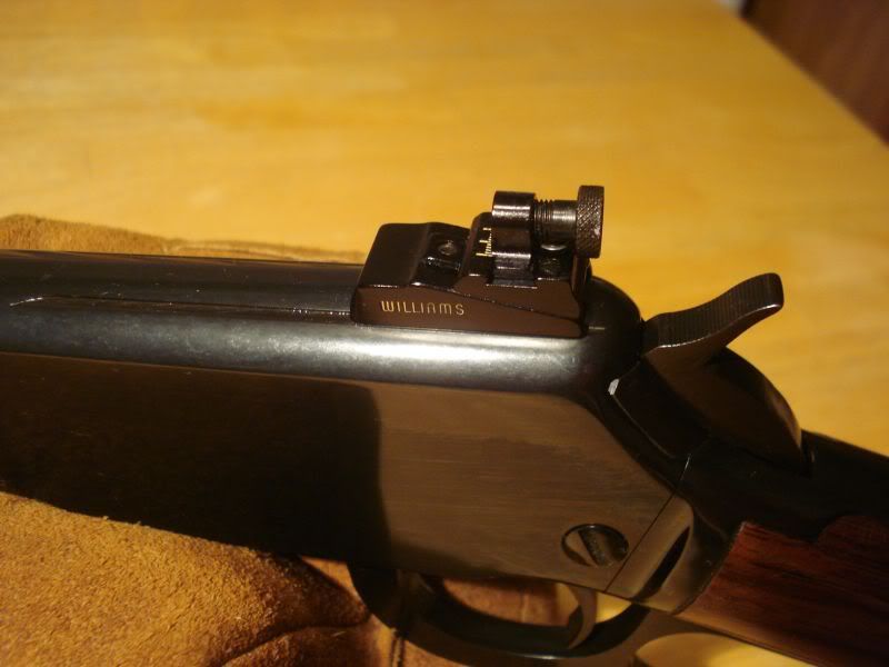

FWIW - The barrel band front sight model is the H001 Standard Henry, and it's only slightly problematic to install the higher front sight required for most of the top-mounted, "clip-on" receiver peep sights.
The available "clip-on" sights utilizing the scope mounting grooves in the receiver cover are the aforementioned Williams WGRS-54, the New England Custom Gun Grooved .22 Sight, and the Skinner Grooved Receiver Sight (made for Henry rifles).
The best way to raise the barrel band front sight for the new, higher, line-of-sight would be to epoxy a bead atop the existing front sight blade.
I elected not to get into the front sight shenanigans, and installed a peep sight that readily zeroed using the issue front sight - to which I applied a dollop of orange sight paint - the Williams WM-96 Peep (which DOES require D/T one hole atop the receiver cover).
Here's the WM-96 on my H001

The WGRS-54
