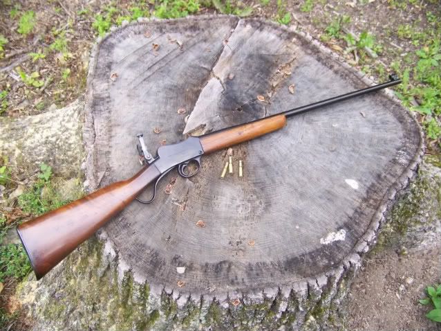

Here is my Martini 218 BEE with a Green Mountain octagon barrel, groove size is supposed to be .223 but is a little tighter.I know you don't want a .22 barrel but I thought I would share my project with you.I have converted the firing pin to a smaller diameter and test fired it with 218 BEE factory loads and there is absolutely no pressure signs and the case just pops out easily during extraction.It has a 1 in 16 twist which was the standard in the Model 65 Winchester 218 BEE,the small pills seam to squeeze down OK.
Regards
Regards
