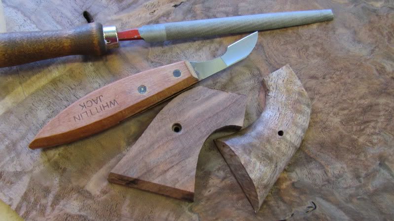

Well I finally got to build a little tool that I have been wanting to get to for some time.
It`s mostly made from stuff from my scrap box along with some simple pillow block bearings I got off of Amazon.
This in going to keep me busy for some time. I have three pairs of Vaquqros that need new grips.
The first ones will be patterns to cut the final ones off of so I can get a proper fit. The factory ones are OK but desire a lot in the fit department and I want exotic woods and fine walnut sets to show off.
I will post some pictures of the finished grips when I get some done.

shouldnt you have the cutter and the stylus at same distance out from the pillow block bearing ?

Friend Alphawolf45 , The main thing is that the pattern and block of wood you are cutting are mounted so the holes are the same distance apart as the distance from the center of the stylus to the cutter.The router and stylus are mounted on bearings also so there is 3 axis movement there.I have locating dowels behind, that are not seen in the picture, to stabilize the pieces as the little #5x40 screws are not very strong. It will duplicate accurately as long as the block of wood is large enough.It saves a lot of whittlin, ( the way I made these ).
should save a bunch of time and make them easier to match up.
I sure wish I could afford a little CNC mill.
For the amount I will be doing,This way will get-er-done. :wink:

Boy for a "scrap" made tool, that is slick. Sure wouldn't have guessed it was from scrap if you hadn't said so. That's a nice piece of equipment.
That has my mind racing with ideas. I wonder if there is a way to make it go up and down? Or does it already? I am thinking of finding a way to copy a stock.

handirifle ,Yes it does go up and down.
See those pillow block bearings under the carriage that the stylus and router are mounted on.
Well that carriage slides right and left and also swivels up and down.
The stylus and cutter can go up and down right and left forward and back and any combination of the above at the same time.
The cutter and stylus swing in an arc but as long as they stay in the same plane they will duplicate.

Do you use a ball nose cutter slightly smaller in diameter to your stylus to leave stock for sanding or are the cutter and stylus of equal diameter?
Bob in Friday Harbor

soon 2 retire , You guessed it friend.
The cutter is 1/4" and the stylus is 5/16" so there is about .030" extra meat to finish off with file/rasp/ sandpaper. :wink:
