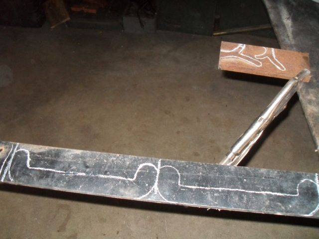

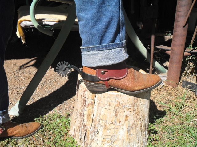

Well Rangeryder got me going with the picture of the old spur so thought i`d give it a go.
This is what we got done today, they will be case color when done.

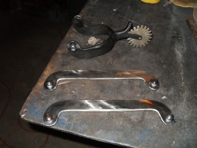

Hey thanks pards, i cut the part that curves around the boot with the plazy then used the side grinder to smooth them up.
Bent them around a piece of pipe , turned the heads of 5/16 bolts down for the strap pins and welded them in holes from the inside.
Not sure about the rowels yet and the leg that holds them but they will be big.
Going to tie into those logs in the morning then will finish these up.
Don`t know if i`ll make any more at this point. :)
The black spur in the first picture is a factory spur i bought in MT.

Thanks guys, i`m back to work on them now, after break that is. :roll: :lol:

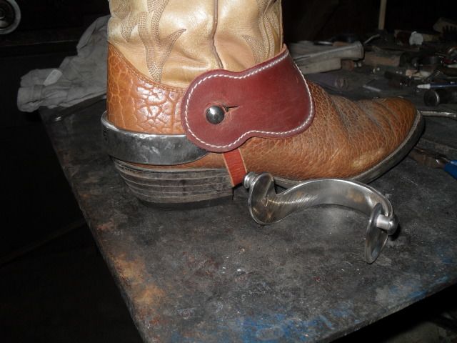

I plan on heating them with a torch so they look like case harden colors, we`ll see how it goes.
Working on the rowels now, got the arms done.

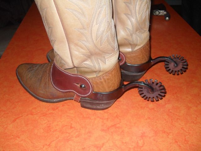

Well here they are pards, didn`t turn out to bad.

Great looking spurs! Any cowpoke would be proud to wear those. You never cease to amaze me. :)

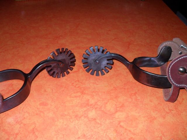

Made another pair, patterned after Monty Walsh`s spurs with locked rowels.

First rate job! I would have made the rowels blunt pointed but more agressive. Don't need Mexican gut hooks, but the hoss needs to know who is the boss.
