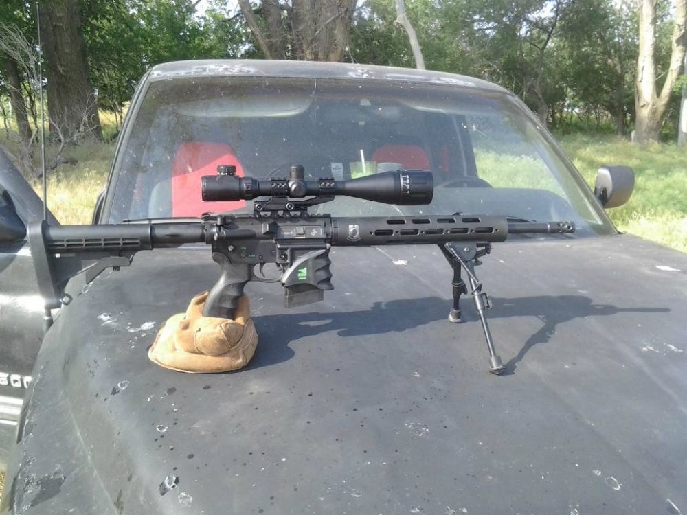

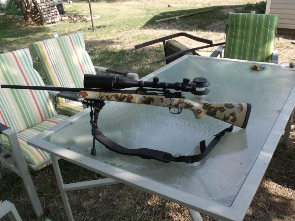

What are grub screws? I am seriously considering going with a Williams Receiver Sight. I have a Lyman on one of my Mauser's and absolutely love it. I generally tend to make one or two loads and stay with them. I have my S&W M&P15 set up with a 6-24x50 Scope for prairie dog hunting and it is deadly accurate. Plenty of terminal hits at over 200 yards. So I dont expect to be loading the 336 for PDogs. I expect to load it for Deer, Coyotes and Feral Hogs. Staying in the 150 to 160 range. We have lots of game in SW Kansas but you dont get close shots very often. I have already started working on the rifle, going to try to make it look brand new except I am going to do a hand rubbed tung oil finish on the American Walnut instead of whatever kinda Lacquer/Poly Urethane finish that is a little beat up but on it.
I have already built these two rifles for longer distance hunting, The Bolt action is a WWII Mauser 98 converted to 308, the action has been trued, the bolt has been redone, Timney Trigger, Timney Speedlock Kit, Bell and Carlson Stock, Caldwell Bipod and Paint by Oneyeopn.
