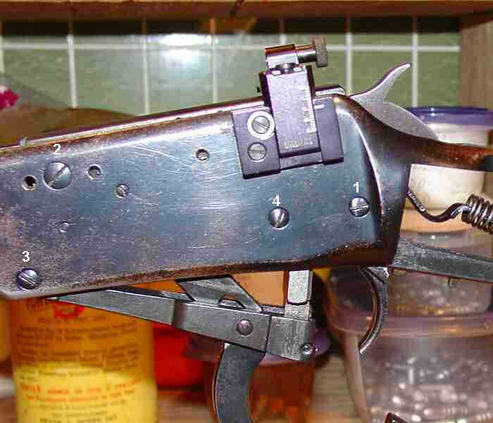

The Winchester 94 action is a different feeling action. Unlike other designs with a single pivot point, the Winchester 94 has two. It makes the lever feel like it has two stages to it, which in fact it does, the first, where the locking lug drops out from behind the bolt and the link descends from the frame; then, the 2nd where the bolt is thrown rearward. The mdl 1886 & 1892 are quite similar, but, with the point of rotation in the locking lugs, they seem smoother. Whereas the 94's rotation point is in the link and farther forward, it's change from down to forward motion of the lever is more pronounced. At least, in this shooter's opinion.
I don't know anyone that I trust more than myself to work on a Winchester 94. Especially when it comes to the trigger/hammer group. The one time I've used a recommened smith with a mdl 94, it came back way too light. I feel that somewhere between 3-4 lbs is perfect on a '94 with no "creep". I simply like them to break without any warning. Whether that's at 3 lbs or 4, it's of little consequence. In either a hunting or target situation, that allows me to concentrate on my sights and "squeeze"... no anticipation. And, no, I won't do someone else's.

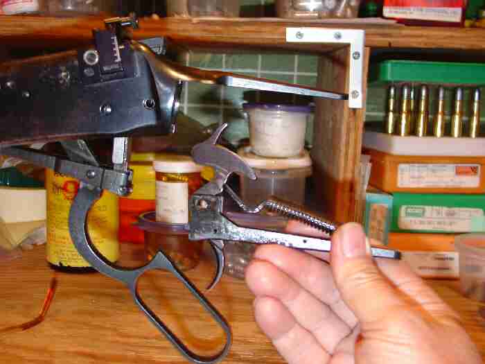

Being that it is some 35 years old, yet used little, all the intervening years have taken a toll on metal expansion and contraction. Before shooting if for the first time, what'd I'd do, is dis-assemble the gun. Clean any remaining lube and gunk out of the action, inspect it for any signs of corrosion. Paying partictular attention to the inside of the magazine tube, spring, carrier return spring, and lower tang parts, including mainspring, trigger block safety, trigger, sear and hammer. While it's apart, check to see that the rear firing pin (in the locking lug) moves freely, as does the firing pin in the bolt. It may not be necessary to disassemble the bolt, but it could probably use some "gunk out" or carb cleaner sprayed thru it. Dry it thoroughly, (I like some compressed air), lube those points where metal rotates on metal with a VERY light coating of grease, and with a dry graphite lube where metal slides on metal. Remove any burrs found on the hammer, trigger, link, and locking lug; and then again in the lever slot where the link/leve pin rides and the frame slots where the locking lug and bolt ride.
When you re-assemble the gun, make sure all the screws in the receiver group are nice and snug, and I use a dab of "blue" loctite on the barrel band screws, but only snug them down to the point at which there's no in-ordinate pressure on the wood or metal. Those are the only two screws that I loctite in place.
Now, I'd fire about 10 rounds or so. Then check all the screws accessible to you in the receiver and make sure they're tight. Then I'd it some more. After about that 1st 100 rounds, I'd reassess whether any further work was really needed. If so, this would be the time that I'd look at that trigger group. If you want to improve the trigger, it is a good time to lightly polish the face of the sear. Note I said "POLISH". But only if you can do so without changing it's angle. It's not overly hard to get it off, but it is possible to polish the sear to remove any machining marks that might be in it's face. Clean the hammer and check for any burrs. I don't fool with the hammer, unless it looks really messed up. (I haven't found one that is unless the rest of the gun was abused).
