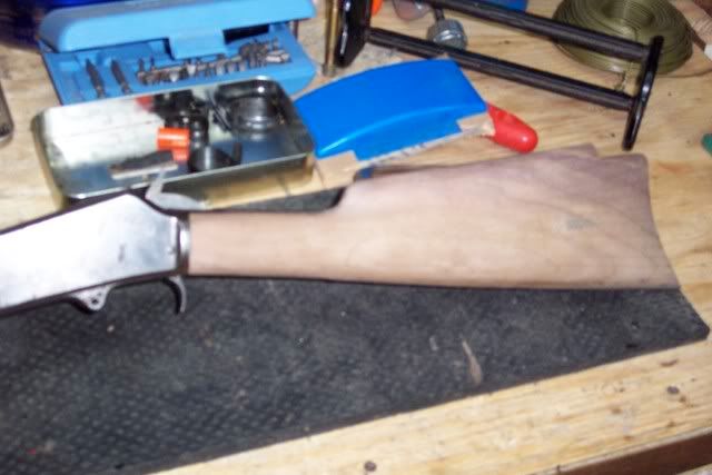

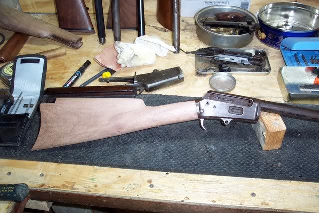

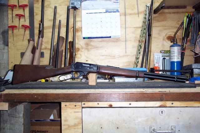

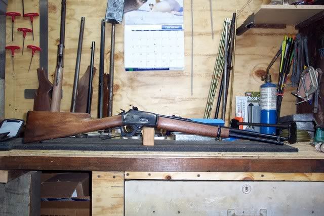

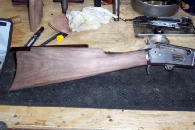

I put some pictures on my puter I thought I might share.
This is my 1894C I just refinished & reshaped the wood a little. The bolt side was very light wood & I had to stain it a bit so it didn't look like pine.
I used Tru oil to finish it & minwax cherry stain on the light side.
This is my 336 44mag I just put the barrel band with the stud on. I'm planing on useing the saddle ring as an attachment point on the other end.
This ones a 1889 38/40. Once I get the butplate fitted I'll send it out to get lined & headspaced. It'll be wearing an oct barrel at that point.
The butplates are current production type & dont fit the original pattern well. I may leave this action alone & not finish the metal. Its got some deep dings I dont think can get buffed out.
This ones a 1894 25/20. I bout got this buttplate fitted. Once its done then just like the 89 its going to Taylor machine for lineing/barrel instalation/headspacing. After that I'll fit the front wood & finish it while the gun goes out for caseing & blueing.
These should keep me busy for a bit. :D
