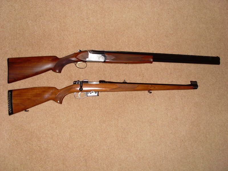

I contacted the UK importer of H&R/NEF he said there was no demand for them in the UK but he could order me one as a special order.. I only have to wait three months for my Firearm Certificate to be renewed
and hopefully I can get one to replace my CZ.
GK Jr. got my CZ and loves it.

GK, that is a stunning photo! The CZ doesn't come in the hornet and hits about $1K here after taxes. Your son's, I assume he has laid solid claim to it, CZ is a dandy with that full stock. I was real tickled to see it iron sighted.

Thanks Bob, yes it's now all his, he has since put a carrying handle on it but I forgive him..Canuck Bob wrote:GK, that is a stunning photo! The CZ doesn't come in the hornet and hits about $1K here after taxes. Your son's, I assume he has laid solid claim to it, CZ is a dandy with that full stock. I was real tickled to see it iron sighted.
This is it with his Parker Hale 12GA.
