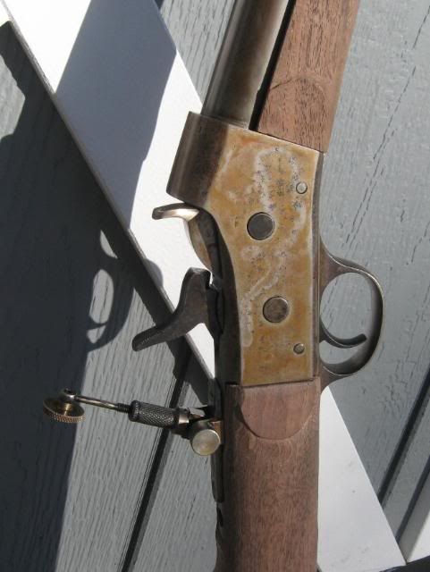

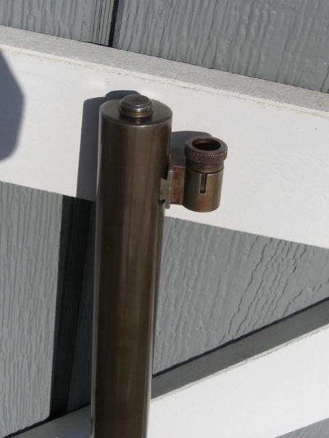

I've done it and won't use BC plum brown again. Here's why.
While plum brown worked OK, I MUCH prefer Dixie Instant Antique Solution.
I did up a Ruger Vaquero with BC, and a rolling block with Dixie.
Dixie ROCKS by comparison, and is a COLD process. If you follow the instructions diligently, Dixie renders a better result by far.
Buy yourself a box of Nitrile exam gloves at the pharmacy and use em religiously during the process. Figure out how and hang all the major pieces with wire (I used copper wire stripped from #12 house wire) so nothing touches em while the coats dry. In either case I did about 5 or 6 cycles. For the roller I waited the required time, so it took about 3 days, but came out ACES.
looks kinda scary while in process.
Note the cast bullet tapped into the muzzle to keep the bad juju out while working on it.
The mottled colors on the receiver reflect the original case hardening effects on the 100 year old gun. The barrel is new.
never really did like the Ruger, but it got better with two or three years use.
