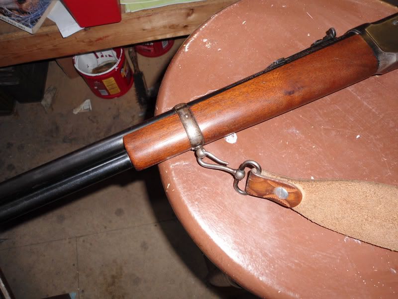

I've drilled and tapped the ones on my Rossi 92's without much hassle. I install the bolt-threaded Uncle-Mike's swivel studs, JB-Welding them in place then filing and polishing the inner surface where it would contact the wood.
Image + Image
The 'clamshell' magazine bands work well, too, and are easiest to do.
