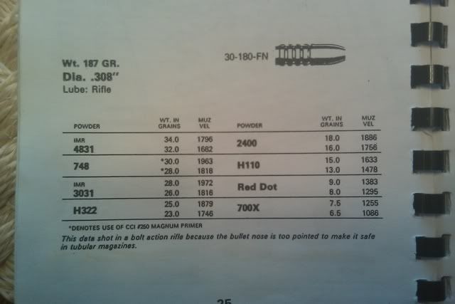

Re: Need input on 30-30 load estimation
Load book photo of page listing the cast bullet you mentioned.
I uses 26 or 29 gr. of RG4895 with the Lee cast 170 gr bullet with gas check. It works well but not at powerful as jacketed.
That chart is very informative. Thanks for posting it. I'm surprised to see a MV of over 1,800 fps using 2400, a medium speed powder. The pressure on that one must impressive.

Great. I sure do appreciate what you have done. Thank you again. I will start low at 25 gr of IMR 3031 and work up from there and see how closely my actual tests match the results you have provided. If all goes well, I'll stay at 1,900 fps (if actual velocit/grains of powder matches closely the curves above).
- Canuck Bob
- Posts: 1830
- Location: Calgary, Canada
I'm going to shamelessly highjack this thread. Could you please rework your program for a 32 Special? The cases are similar enough to ignore the very slight difference and the only change would be a .321 bullet. I am always curious of the difference the expansion ratio makes with these two cartridges. In the interest of full disclosure I do own a 32 Special 94 and think heavy lead like Dirk's bullet is the ticket for me.
Edit: I just reviewed the data chart and realized that I have no idea about bullet length and seating depth. Except that the equal weight bullet is shorter and seating depth is less for equal COL. I suspect this is fairly critical for the program.
